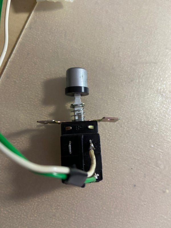

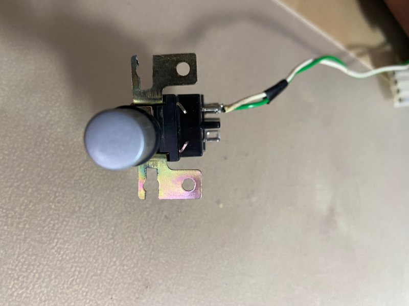

Performed this fix... works excellent... used these:
https://www.amazon.com/gp/product/B07GN1YR2V/ref=ppx_yo_dt_b_asin_title_o09_s00?ie=UTF8&psc=1
Had to use my dremel with cut wheel to trim slots into metal tabs. Also, so switch would work correctly with enough room to push up and down when installed, had to trim off top nub on plastic shaft and very slightly adjust leftover shaft nub & indent line so switch cap would fit onto it ( I broke one shaft in the cap when adjusting so glad I had more switches). Note: Picture below shows test fit of cap on shaft before I cut top nub off to allow it to sit lower ... so switch would function correctly once installed in plastic holder.
Can confirm wiring to the two terminals on one side of new switch is correct. Note: Upon reinstall, put screws into assembly before moving into place as it's hard to get the screws into the holes once put in place.. you can then tighten down from there.
Works perfectly and very solid. Thanks for the advice... Phillis 212 is working again !!!

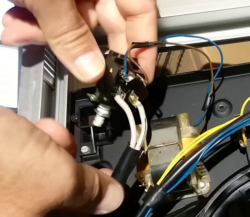

Hi, all. I dug out my old GA222, only to discover the infamous failed power switch. As suggested in this thread, I ordered an AT computer power switch to replace it, followed all of the instructions on the thread here (wired the two power leads to the top 2 terminals, the brown lead to the bottom left, and the blue lead to the bottom right), and hooked it up. The platter is spinning at about 1000 rpm! I don't know what could be causing that. Does anyone have a clue how I can troubleshoot, or should I abandon hope?

Here is how to modify the mounting ears of the new switch. Make sure the slots are wide enough to easily slide the screws in.
Push the knob onto the new switch before you mount it in place.
Cut the two wires off the old switch, strip them and wire them to the new switch. Use the two terminals on one side (either left or right--it doesn't matter which side). Wire color does not matter.
Hope this helps to resurrect some Philips 212 and 312 turntables.
Rick
