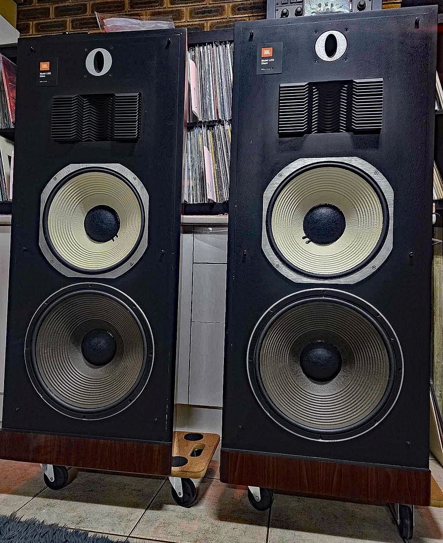

Interesting, again! What midrange horns did JBL put in the L-220 and L-222? I know nothing about them, either.

Some later 4-1/2’ cones,ceramic Le5-? with a bigger pair of lenses in front of them
And that’s why those speakers failed. All JBL needed to make them great was a pair of Dlh175’s
Instead of the cone mids. Their bass and highs were excellent

Really? They had cone midrange drivers hiding behind those lenses? Not horns? No wonder the 076 had to dip down to 5kHz.

They used the LE-5 and the "wavy" plate.

As for the L-220, IMO never was so lousy sounding a speaker so well made, a major distortion and compression generator; the LE-14 woofer was overtaxed for the intended use and the voicing was boom and sizzle. I was given 4 of the things, gave 2 away and parted out the others, a guy in Norway was keen for the 15" passive radiators. The boxes I sealed and used with Bozak coaxials as surround speakers. The cats eye tweeter is good, way better than the bullet but not better than the slot as my memory serves me; it was a long time ago.

Can I ask how you compared the 076 in the L-220 versus the 077 in the L300 (or others).
