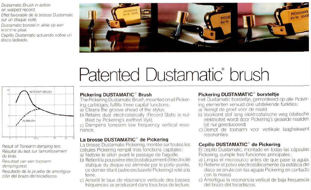

However, my disagreement lies in my understanding that despite it's appearance, I have heard that the Stanton/Pickering cart brushes aren't to clean the record. They are a part of the cart's design, to assist with tracking (particularly with warped records). I have heard that the sound better with the brush.

Vwestlife posted this in a past thread. Cleaning and resonance damping were both claimed advantages for the brush.
While I am no expert, my experience is that the brush is self supporting on the record, but obviously not in free air, so if you balance the arm and then increase the tracking force by a gram, you have set it up correctly. I also believe that the the brushes increase skating force, so I increase it a gram.
It seems obvious to me that having a brush that is held onto the stylus assembly by pressure will couple the masses slightly, and that this will help to damp the cartridge/arm resonance.
I don't see the brush as a cleaning device, I see it as a damping tool.
