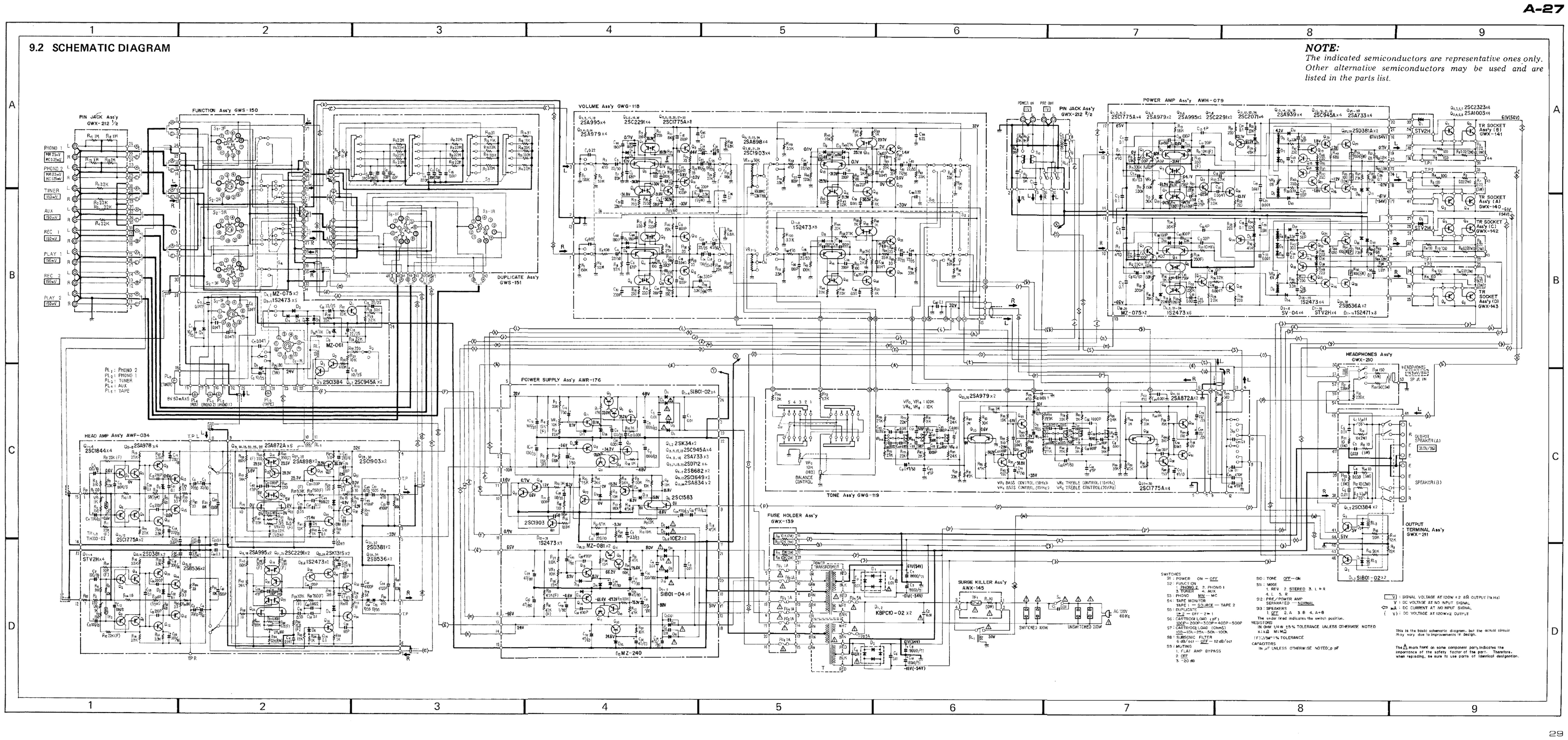

Looks to me like the power supplies are all good now.
The Protection circuit, muting and relay switching are all logically mixed together, gotta study the SM. Those functions are unreliable on the DBT, you have to be off the DBT to verify the timing and proper function.
Also working on getting a better schematic.
http://www.wwdsltd.com/files/PioneerA-27Schematic.jpg
Here is a link to download a full schematic in one drawing. It is much easier to follow than the one in the SM. Be aware that it is for the KU (USA, 120v) version, so the primary side of the transformer does not have the multi-voltage option in the drawing that the S or SG version usually sold over there has. The main part is usually the same.

I have the Kallhovde manual, with some EU-Model extensions, but the complete schematic in one picture comes in handy and is new to me. Thank you and Watthour (I knew him from his postings) for excavating this schematic!

So, following the wire path from power supply pin 14 (+24V), I see it supplies to relay RL1 on Pin Jack Assy (pin 5 on GWX-212) coming pack to pin 11 power supply.
(It also supplies a relay on Headphone Assy (pin 51 on GWX-210), which comes back to pin 10 on power supply.)
As I measure +24V instead of 1.6V on pin 11 power supply, when the relay does not click, this seems to be simply the output of pin 14 then.
Is it correct to assume, that either the relay is bad or more likely Q21 of power supply does not allow the relay's current to flow?
Edit: Added pin-#
The +24vdc on pin 11 indicates that the relay coil is good, but Q21 is not conducting current to pull in the relay.
Measure dcv on pin 16 (the base of Q21), sb about +0.7vdc.
Measure DCV on the collector of Q17, sb about +16.2vdc.

Q17 is high. It would be good to know the emitter and base voltage measurements.
If D19 is damaged, the result could be a higher base voltage.
