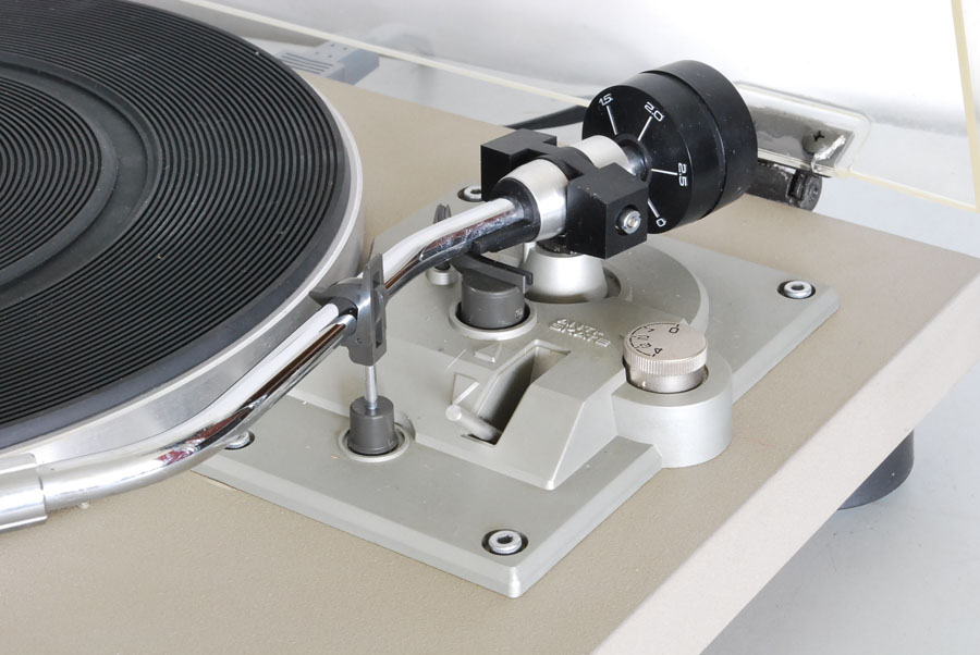

I just purchased a Pioneer PL-518 that needs some restoration, and I am trying to check out its operation capabilities right now.
The existing cartridge is an ADC XLM MKII Improved, and I checked the wiring which had the RG and RS wires backwards which I have corrected. I have not checked to see if the overhang is set proper.
Setting the tonearm level balance I find the counterweight needs to be almost completely forward on the shaft. The recommended tracking force is 0.9-1.5 grams, but I can only add 0.5 gram until I am completely forward on the shaft.
If I set the counterweight up like this and set the anti-skate to 0.5 my tonearm will not track across my test record.
I am not experienced with this type of work so what should I be doing at this point?
You need a bit more mass on the cartridge end of the tonearm. Could you provide some photos of the headshell and cartridge setup and also of the counterweight on the end of the tonearm so some knowledgeable people could identify whether some component has been changed resulting in your problem?
Do I understand correctly that, even with counterweight fully forward, closest to the tonearm, there is insufficient tracking force to play a record?
Do watch Balifly's suggested video, just to be sure that you are adjusting it correctly.
four images of my setup: tonearm from above, tonearm from side, headshell side, headshell front.
The "headshell side" shows the tonearm in "balance" as I followed the instructions in the owners manual.

That's the wrong counterweight and likely heavier than the correct one. On the other hand, the headshell is the original.
John
There's the answer I was looking for. I knew someone here would be able to see what was happening.
You could try to mod the one you have to work by taking weight off if it. My pl518 counter weight weighs 119.95 grams. Little scales like this one are nice when checking things on turntables.

OK, I brain-locked last night so disregard that post. You would have to go with a heavier headshell than the one you have to be able to back the counterweight off. Your headshell weighs in at about 10.8g w/o cartridge so it seems like it's already pretty heavy already.
