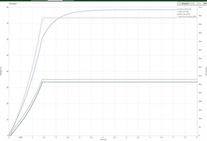

I did some basic circuit simulations of the circuit to understand which component values affect the behavior:
https://www.multisim.com/content/6mcxcduwdvSLFb8qp4d8Wk/pioneer-sx-1980-80v-rail/
I haven't found any way to slow down the +34V rail versus the +80V rail. These two are linked pretty linearly.
I see that selecting C216 affects how fast the +80V and +34V rails come up.
I couldn't cause the circuit to "lock up" like I am observing, but I suspect I'm kicking off some nonlinear behavior that isn't capture in these basic models.

Here's a trace of the simulation, showing how the +80V and +34V rails come up together. Not sure if the Zener voltage is realistic or not, since probably depends a lot on the Zener diode model.

Thanks for the suggestions. I've changed out all the electrolytics in the +80/+34V rail. The only silicon that I haven't changed is Q214 (NTE194) and the diode D214. When I wrap this up succesfully, I'll summarize with all the replacements that I used.
I think I'm getting closer, here goes:
I disconnected the load from the -34V rail (removed pin 11 from the AWR154 board). Now fast start-up is OK.
My working hypothesis:
  • Observation: The turn-on speed of the +80V/+34V and -80V/-34V rails are very different. The -80/-34V rails are really fast (< 1 second), while the +80V/+34 rails are slow (several seconds).
  • Modeling: The key parameters that affect the turn-on speed are: C216/C217 capacitance (the electrolytic capacitor across the Zener diode) and the current value supplied by the current source.
  • Statements of fact:
  1. I replaced the upper rail (+80V/+34V) with the solid 2mA @EchoWars current source built in @markthefixer style.
  2. I kept in place the JFET current source on the lower rail.
  • Working hypothesis: The fast turn-on of the lower -34V rail is loading the +34V rail. The loading on the +34V rail prevents the +35V from appearing on the Zener, and the upper rail voltage cannot rise sufficiently to kick-start the regulator and the regulator feedback.
So far, I have been following my mentor's mantra of "fix it first, upgrade it only when it's working".
Now, I have determined it is now the time to break the rules and upgrade the lower -34V rail with the 2mA echowars current source in MTF-style, add new transistors and new electrolytic capacitors. I will upgrade the transistors to ensure plenty of voltage margins, to prevent any blocking voltages from being exceeded with this new modification.
Quick summary: The upper and lower rails should be matched in transient performance, to prevent one rail from loading down the other rail and prevent it from starting properly.
Lesson (not to be overdone, though): This may be a rare case where implementing fixes a piece at a time can cause problems.
Now on to heating the soldering iron, cleaning the magnifying glass and staring deeply into the bright inspection light.
Ok, so took a deep breath, dove in and now my hypothesis was confirmed: One must provide similar currents from current source on the positive and negative rails to ensure reliable startup of both power rails.
Of course against typical best judgment, I wholesale replaced all the transistors and capacitors. I dim-bulbed (starting with 40W, then to 100W) and Variac'ed the heck out of this when bringing it up.
Now, all is copacetic and both positive and negative rails startup reliably. This SX-1980 sounds really good and the weight of it it now keeps my workbench from flying up.
Y'all are awesome for providing these great resources to lowly apprentice techs like me to solve tough problems.
Especially thanks a lot @markthefixer, I hope I did you proud on this one.
