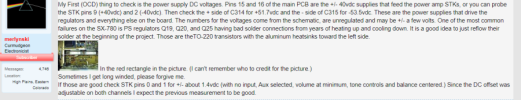

merlynski posted this about the SX-780 that I saved regarding the regulators. After reading this about Q19, Q20, & Q25 I've always refreshed solder on those whether they look bad or not.
One unit came in not working and the first thing I did was refresh the solder on them and it then worked.
