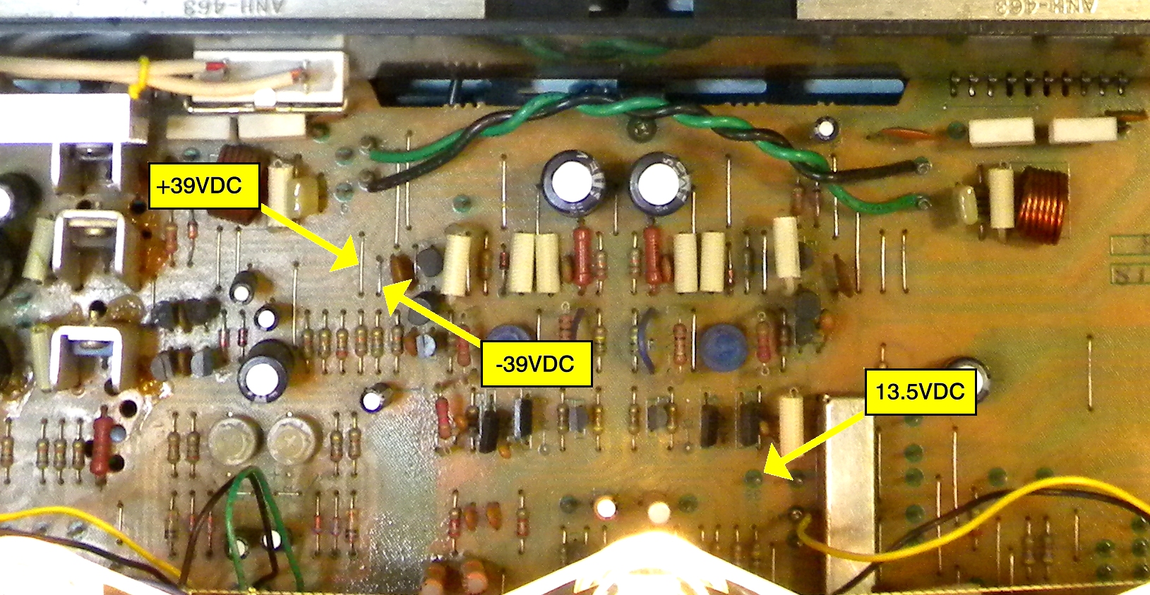

well, you are correct to start at the +13v since phono and aux are far less affected.
Let's see a picture of your DMM / volt meter (or tell us the make and model)
Black dmm lead to chassis ground, insulate all but the tiniest portion of the tip of the red probe. Set dmm to read at least 60 volts without overload.
Take and post DC voltage readings for pins 60 and 7 (they connect in the big white 220 ohm 5 watt off board resistor on the heat sink) on the big gwk-119 af assembly board. That will tell us a LOT.
It would be helpful if you had a cap (1 uf 250 v non-polarized) like this:
https://www.radioshack.com/collecti...radioshack-1-0uf-250v-10-metal-film-capacitor
when put in series
(red probe to one lead of the cap, the OTHER cap lead becomes your probe)
with your red test probe it blocks the dc part of a voltage reading and allows us to ferret out the AC part of a voltage reading (depending upon your meter)
If you have or get a cap like this, make AC voltage readings of pins 60 and 7 as well.
Practice finding Q26 (2sd712) - it shows in your picture. post another picture with arrow, IIAC it is the ONLY D712 marked transistor in there, and additionally, it's on it's own small aluminum free-standing heat sink.

Yes, Q26. Please measure and post all three of the leads' voltages referenced to a good chassis ground - That would be a good beginning.
If you review Mark's earlier post, it described attaching a small capacitor to one lead of the multimeter to filter DC and measure any residual AC voltage. Prepare one of the test leads in that manner and measure the AC voltage at the collector lead (case) of Q26 as well.
Q26 is the +13v regulator.
3 leads on the device, 3 voltage readings, plus Watthour's request to measure the tab voltage with a blocking capacitor.
actually, considering the SX-880's layout, measure all three with the blocking cap IN ADDITION TO the DC voltage measurements.
BE ULTRA CAREFUL NOT TO SHORT ANYTHING. insulate all but the tiniest portion of the tip of the probe(s).

Here are the measurements I took this morning with FM on and tuned to a strong station:
Pin 60 -- 12.7v
Pin 7 -- 40v
I pulled a 470uF 25v cap out of an old cable modem and took some measurements with that cap in case it might be useful to you guys:
Pin 60 -- 10.8v
Pin 7 -- 38.5v
Finally, I wanted to mention that there is an awful lot of brown, bubbled gunk at the base of all the transistors on that board. Does that indicate that they have failed?

Unfortunately, 470µF is a bit large to get what we are seeking. There is charging time involved when capacitance it that high, and that would tend to depress the RMS voltage reading of an AC wave.
Brown, hard residue is very likely the glue used in assembly to hold the larger components in place before wave soldering. Larger capacitors, cement resistors, larger transistors and their heat sinks, and other pieces with any appreciable mass were often glued on the assembly line before soldering. Some of that is visible here:

Here are the measurements I just took on the Q26 transistor (2SD712) without the cap. Zebulon1 will be sending me a cap by mail on Monday. Thank you very much. Per the online spec, Q26 is a NPN transistor with the poles labeled B, C, E. I think B is the center pole, but you all know more about this. So, here goes:
B -- 12.3v
C -- 11.7v
E -- 12.4v
Does this indicate a failed transistor? It will probably be a week before I can post the readings with the cap in place (unless I am able to get the cap from one of my local buddies).

Please measure the voltage at both ends of R220. That's the cement resistor attached to the large heat sink in the unit.
Also, if you have another electrolytic capacitor, something larger than 50µF and over 50V, it may be useful for diagnosis shortly.
I did already measure the voltage going into that big resistor from pins 60 and 7 (12.7v and 40v). Are you asking me to measure the voltage at the board level rather than at the inputs to the resistor?
40v to 12.7v across 220 ohms at 5 watts infers 125 milliamps of current ( ~3.4w )
meanwhile, those transistor voltages stink.
they are so close together i can't tell if it's shorted or just not being turned on.
collector should be the largest of the three readings, greater than the base.
base
emitter should be 0.6v LESS than the base
might be instructive to remove it from circuit, and remeasure the empty collector, base and emitter connections
OK, I'll work on removing the transistor today and post the readings from the empty C, B, and E connections. I'm not sure I've identified the transistor leads correctly, but I think the center lead is the collector. I can also test the transistor using diode test feature on my DMM. I just watched a few YouTube videos on how to do that. Stay tuned for more measurements Thanks again.
Here are the latest test results with the transistor removed from the board. The transistor pins were all labelled on the board, so I have the correct layout now.
B -- 12.6v
C -- 47.4v
E -- -0.1v
Pin 7 -- 47.4v
Pin 60 -- 47.4v
