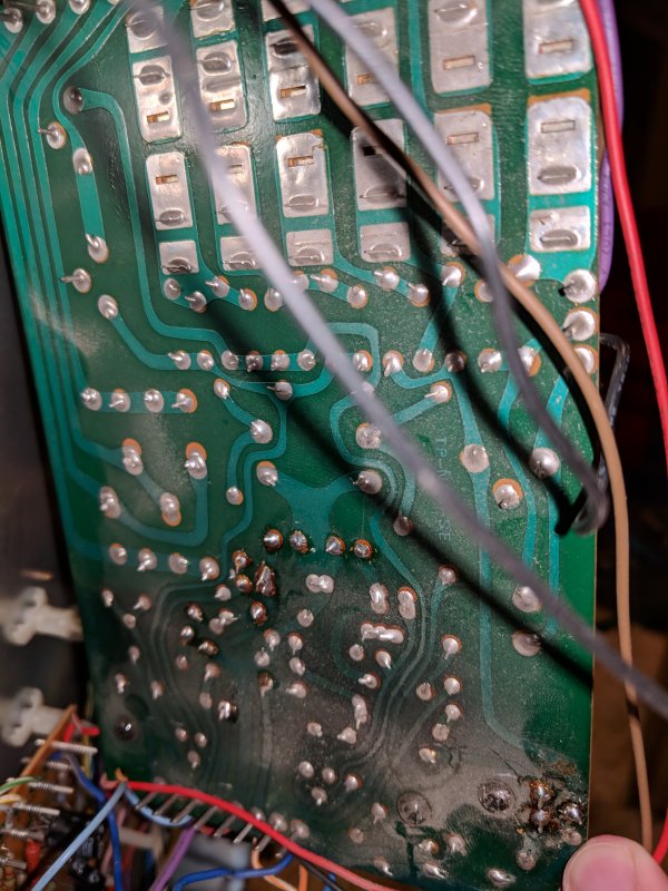

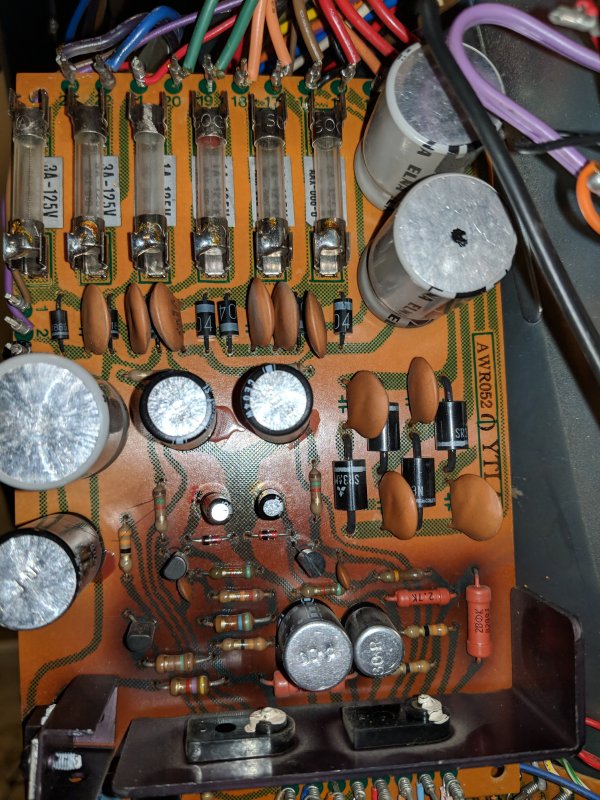

Hello, I recently obtained this SX-939 in really nice cosmetic condition. The only problem that I noticed was that it would drop FM signal after about 10 seconds of powering up and then remain off. All other inputs seem to be working fine. After cracking it open to take a look I noticed that the power supply board looks like it has been cooked.
I've decided I want to put new capacitors and transistors in the power supply board. I also want to order all the components listed by larry and mark in larryderouin's rebuild thread for an eventual total preventative revamp.

After checking the post voltages on the power supply board these are the results:
1 = ~10mv
2 = 8.1v
3 = 0.0v (problem seems to be c24 and c22)
4 = 0.0v (problem seems to be q6 that nasty looking one my finger is pointing at in the pic)
5 = 35.1v
6 = 47.5v
7 = 0.0v (problem seems to be c15 and c16)
8 = 25.9v
9 = 33.0v
10 = 14.2v
11 = 24.7v
I could really use a shaman right about now..
Just redid a 939 two days ago. Absolutely use Nichicon PW or similar 105 rated caps for the power supply!!!! Bump all those red resistors up in wattage by one and space them, bump the 1/2 watts to 1 watt. Replace all transistors on that board as well. It without question needs it.
Just use normal caps for the big ones and use some sort of foam around them to make sure they stay.

So I ran into a problem. I blew the board tracing between pin 13 and C8 and D6 on the power supply board. This happened after installing the new filter capacitors. I did not replace capacitors C5, C6, C7, C8 or D5, D6, D7, D8. Should I replace all of these now? Not sure what to do. Anybody have any thoughts?
Is it normal for the unit to go into protect mode when connected to a DBT, speakers and the volume turned up loud? Doesn't seem to go into protect mode when I disconnect the DBT.
Yes. The DBT will limit current as well as voltage. When you crank it, you're basically strangling the parrot(protection board is sensing a problem), so to speak with a voltage drop.
