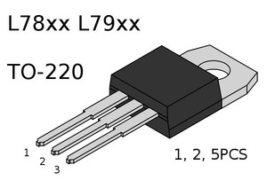

ok you need to find out where q1 is .. or measure capacitor voltages that were mentioned earlier . be worth checking solder joints to rule those out .. always my first call
On the 950 the TO-220’s will develop loose/cold solder connections. It might only need to be reflowed?
