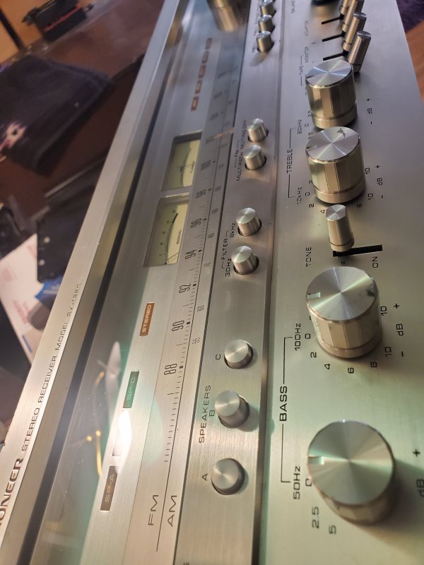

I'm sorry I don't have any before pictures and my ones from while I was working on it were lost on my old phone. I can take some now. Just let me know what you would li,e pictures of.
This the faceplate after I re machined the damaged parts.
