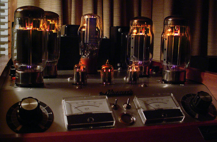

I've got a set of Psvane HiFi's that sound good, but the bias bounces around some - I end up having to tweak them every start up.
Went with a set of TungSol KT120's and no going back. As said, they're just a sweet, solid sound top to bottom and rock steady. Per KWard's advice, I bias mine at 60mV (the spec for my amp is 55mV) and they really sing.
And yes, you DO need to make sure your amp can drive them properly due to the higher supply requirements. And yes, you WILL get a bit of a boost over what a set of KT88's can produce. You won't see the KT120's full rated power unless an amp is specifically designed for them, but you should see a good 10% watt increase. You should also see major improvements in durability and longevity as you're not going to be working them all that hard in a KT88 based amp. Another selling point is they're very reasonably priced - a matched quad will run you less than $200 anyway.
And most importantly ... they're PRETTY!
I love BIG BOTTLES ... I mean, these bottles, they're just so big. I can't believe they're just so round, they're like ... up there!
Sir Tubesalot
PS ... the KT150's are neat, but at twice the price of the KT120. Haven't heard much about the sound, as there's not a lot of interest so far.
