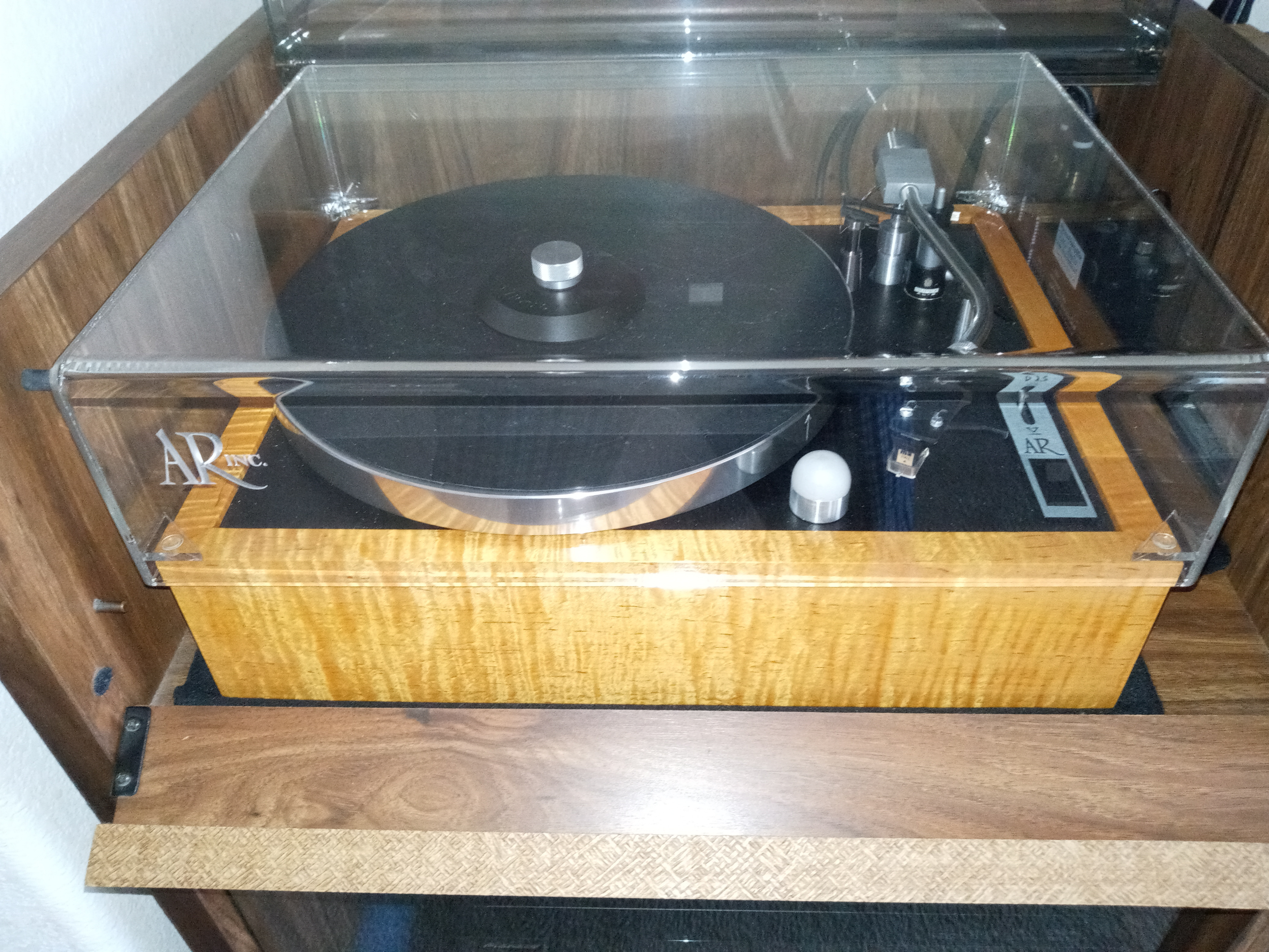

IMHO I would highly recommend doing a full restore of your AR table , I have had mine forever 4yrs now and as I have said many times before I will never part with it despite having table that cost more than twice what I paid for it.
My XA is not at all embarrassed next to my Nottingham Ace Spacedeck with Audiomods Series 6 arm and that is saying a lot as the Nottingham is an exceptional performer and although it is more refined than the XA the XA does not give up much as price might have you believe.
I will also say imo the the XA is my art piece table it is so stunning in its looks (imo) that even while playing my Nottingham I find myself starring at the XA’s beauty. The performance of my fully Marc Morin (Rest in Peace) Modified table is mind blowing and an absolute pleasure to listen to with any record. So with that said I would fully restore it and maybe do a custom plinth if that’s your thing. Here’s mine and good luck :thumbsup:
Audiofreak71
IMHO, do a full restore. What you see here was about 600 dollars total, plus cost of turntable.
It hangs with my 2,000 dollar Music Hall 9.1.
View attachment 2293710 View attachment 2293711
I'd say you got off easy at $600, depending on what's under the hood. Marc did everything he could possibly do with mine, the "full monty", except that I opted to keep the top plate stock since it was in excellent condition and I like the hammertone-like finish. Mine was a little over $800, not including dust cover and accessories, but including a new motor because the original would start cogging randomly even after Marc tried to remedy the situation. Like Audiofreak71, I will never part with mine.
