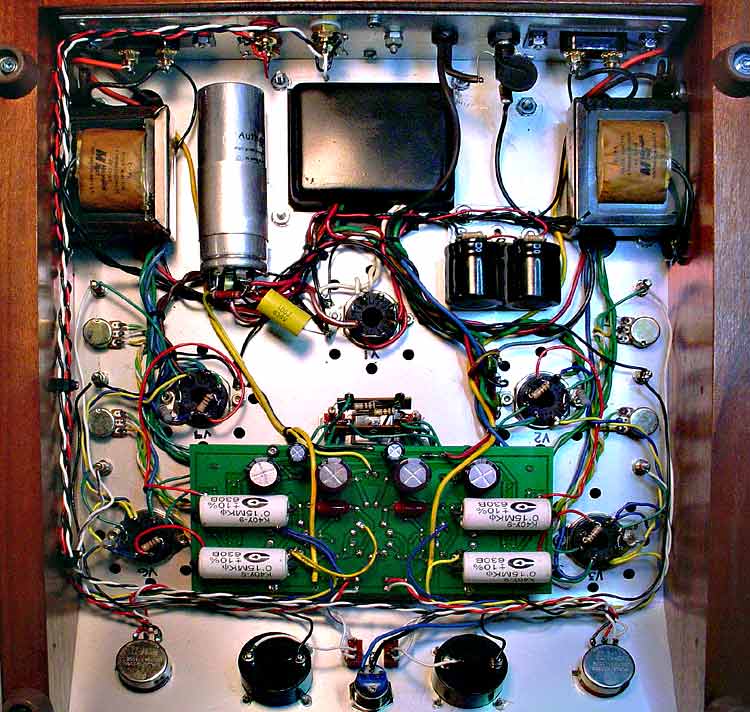

Certainly something to be said about the seamless look, but wondering if instead of having the labels professionally printed (which I expect cost dearly for a low production run), you could just print them yourself on photo grade paper and stick them to the new heat shrink? I did something kinda sorta similar on a recent project ... those would be the white PIO's on the circuit board ...
Also wondering about the twisted leads. Any purpose other than increasing the effective gauge of the wire?
Would it be possible to only cut off the bottom edge of the original shrink wrap, and hide the removed area under the clamp?
Maybe it could… but I am not sure will be the original heat sink, during the time, pull back more from the bottom edge of capacitor case because of heating inside of amplifier (receiver), so I decided to replace all heat shrink cover with new….
...but wondering if instead of having the labels professionally printed (which I expect cost dearly for a low production run), you could just print them yourself on photo grade paper and stick them to the new heat shrink? I did something kinda sorta similar on a recent project ... those would be the white PIO's on the circuit board ...
Yes, that is very good idea! But, I did on that way, it cost, but now it looks very nice for me.
Just because of increasing the effective gauge of the wire, nothing else.
