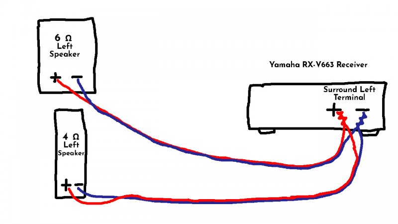

2>> I connected each speaker as usual (+ & - cable wired into the speaker cabinet), twisted the 4 positive and negative ends to blend them into 2 positive and negative wires,
then connected in-phase into their respective binding post terminals. I believe this is considered parallel wiring, but maybe I'm wrong about this.
Is this the best way to connect this type of multiple speaker setup, or is there a better way? Again, all is working fine, except for the difference in mismatched speaker volume.
Attached is a schematic of the wiring I am asking about >>
some speakers will naturally sound louder than others with the same amount of power. .
The different impedances may have a little to do with that but even different speakers with the same rated impedance will have different volume levels. That's the nature of the beast.
Yes, that is parallel wiring.
some speakers sound louder than others with the same amount of power. That means that some will sound louder than others.
Its all about sensitivity. ;)
Although, to your point, impedance does have some influence on power distribution between the two speakers.
It might be worth trying the speakers connected in series, rather than in parallel. The combined impedance would then be 6 + 4 = 10 ohms. Ten ohms would be an easy load for your amplifier, which is rated at 8 ohms, to drive. The surround sound would be very likely still be loud enough, and you'd have no worries about overloading the amplifier. To connect them in series, just connect the - terminal of one speaker to the + terminal of the other. Then connect the remaining - terminal to the corresponding terminal on the amp, and the final + terminal to the amp's + terminal. You will now have just one wire to each amp terminal, and not two. You may or may not like it as well as your present setup--it may be better, it may be not as good--but, as with many things in audio, the best way to find out is to try it!
