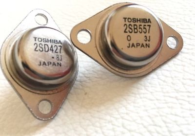

First thing I'd do is check Qe27 ,28,29 and 30 out of circuit.( output transistors ) If they check out OK. Then check rectifiers De19 thru De26 bridged rectifiers. On the rectifiers lift one leg of each one to diode test them. I wouldn't even bother powering it up again until you locate the short circuit.

Mica insulators were intact. Tested output transistors and 3 of them are bad. Any point in checking the rectifiers as part of identifying the short circuit without working output transistors in place? We went ahead and tested 2 of them and got values of 0.50 and 0.53 - quite low, I believe. Do you recommend replacing all of them as part of the repair?
BTW, could the bad output transistors have been the cause of the blown fuses?

Yes
MJ21193G and MJ21194G from Mouser or Digikey <---------- 2 of each
