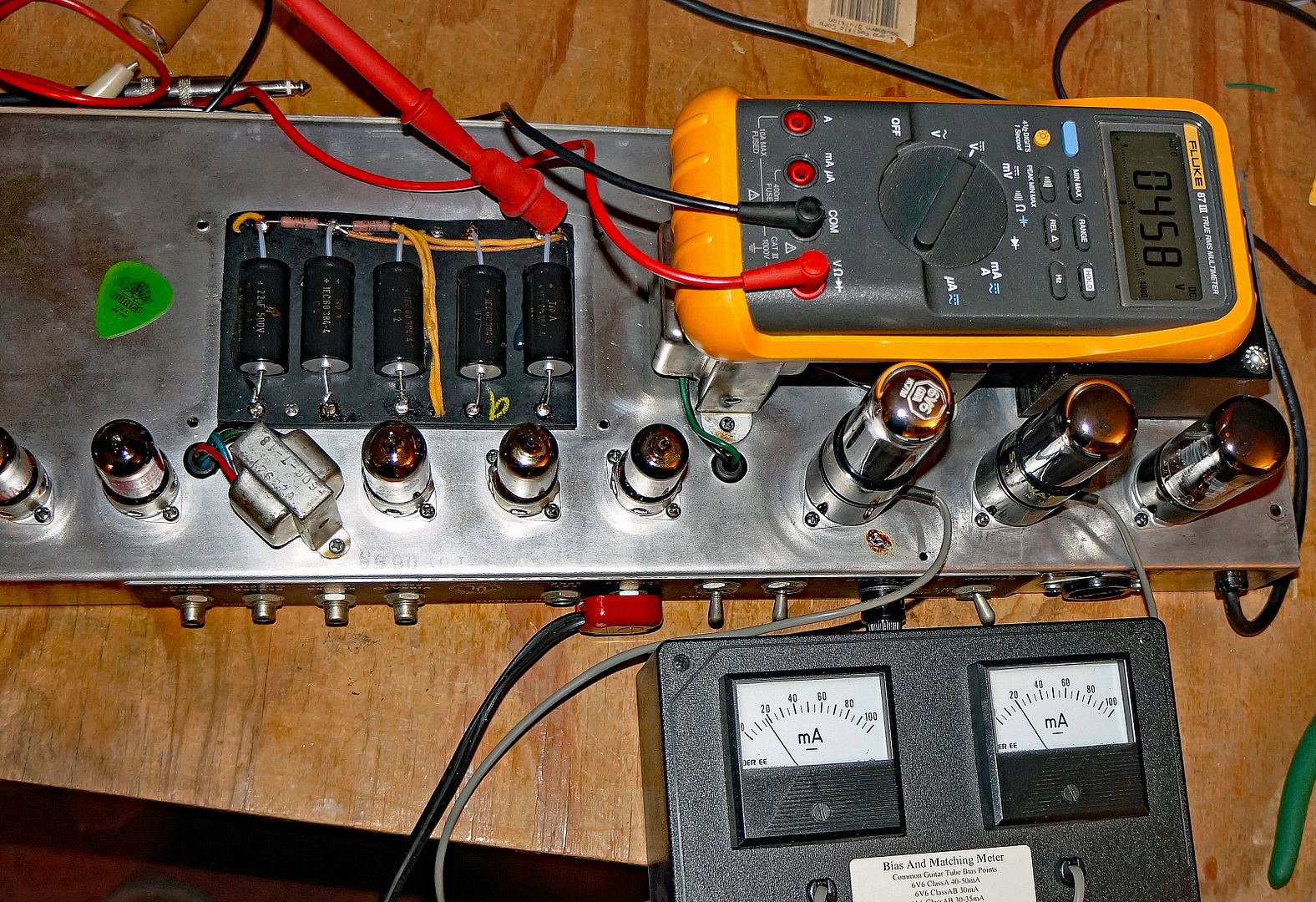

One absolutely hardfast rule of live amp testing, especially tube amps, and really most electronics, is one hand only. Tie the other arm behind your back if you must. Two hands and you're begging to become part of the circuit. You can still kill the amp with a single probe, but you're much less likely to hurt yourself. Clips exist for a reason. Use them.
