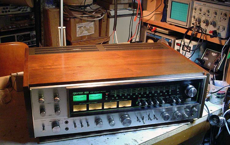

PS - if you want a DIY project that includes the double sided board, don't half step ... I rebuilt my QRX quad, but wouldn't try that again on a bet ... ;-}
(my preciouosssss )
