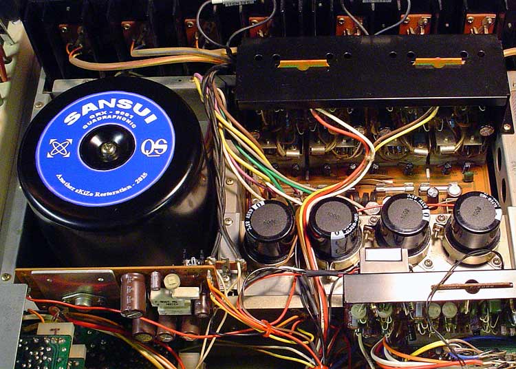

Yup ... but I do believe it's an official Sansui substrate. Could be wrong ... either way, should be good for a polarity check.
That board shows up all over the place. Here's a couple, looking right at home in my restored QRX-9001 ...

Not seen is an old power strip with several different wattage bulbs loaded up in adapters. All that screwing is kinda hard on us old guys, doncha know ... ;-}
