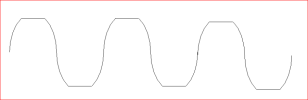

Ok, so what else could be reason of the bad right channel? The sine wave on the oscilloscope doesn't look perfect at the peaks, I don’t know how to explain it. Was something like that
The top and bottom of the waveform are clipped, very evenly I might add. Is this at the speaker output of the amplifier?
Are you sure the input to the scope was not overloaded, voltage range set too low?

Finally, I brought the amp back to life last weekend.
One thing that still didn’t let me relax was the output transistors. The original 2SC1079 and 2SA679 were replaced with MJ15004G/03G, but they probably weren’t good enough by spec. So, I swapped them for MJ21194G/93G—the ones I had used when restoring a Yamaha CA-800 (that’s another story)—and everything started working fine. I adjusted the DC offset and bias, and now it’s ready to go. The bass is back, the sine wave looks good, and there’s no distortion or other noise.
