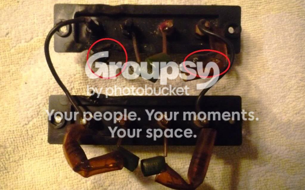

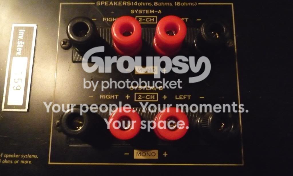

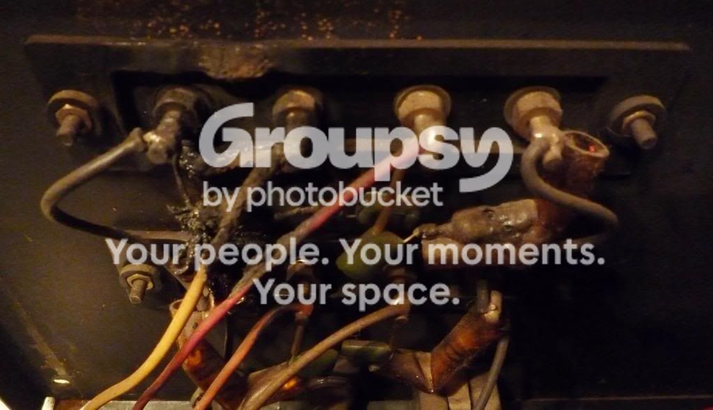

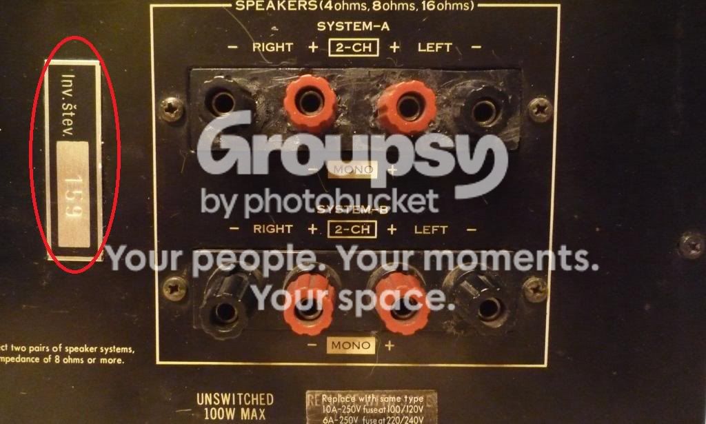

For the last few weeks (from time to time) working on ruin BA-3000 amplifier. According to this label (inv.number) on back plate, was owned by some institution for a long,long time (like cinema, theater,church...etc) and had a hard life for sure :tears:
Just take a look at that poor binding posts
And another view:
What could cause such a melting of resistor on one pair of speakers??

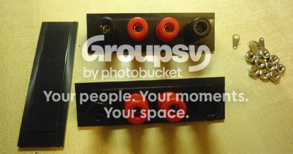

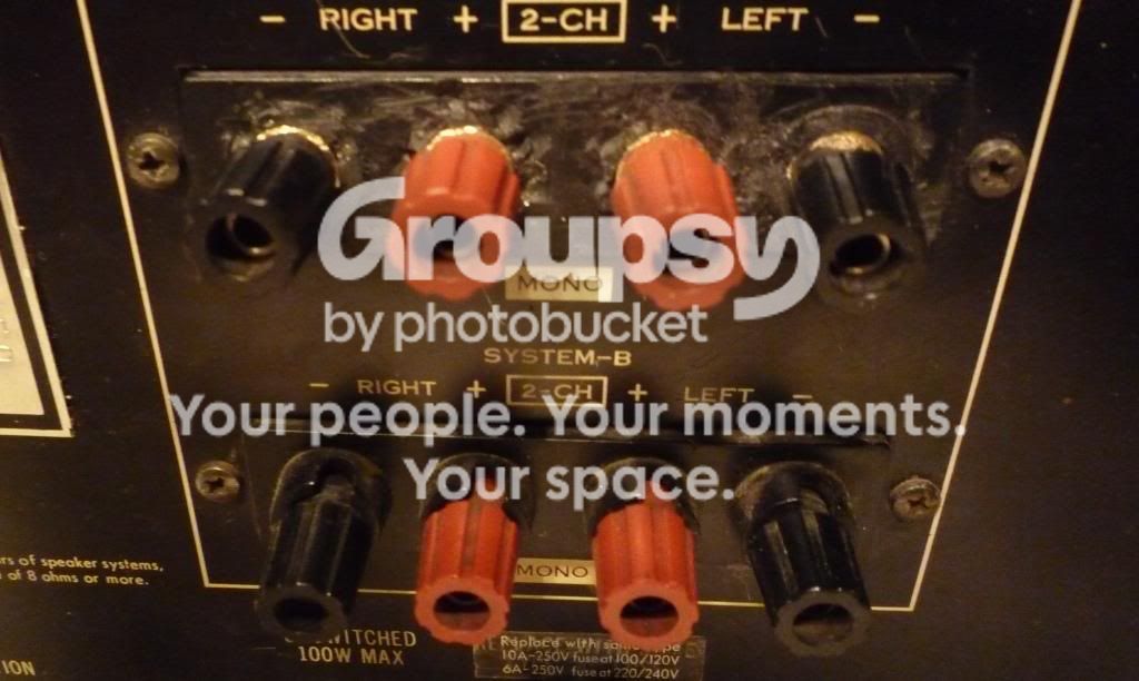

Since old binding posts are useless, it's time to make new one:

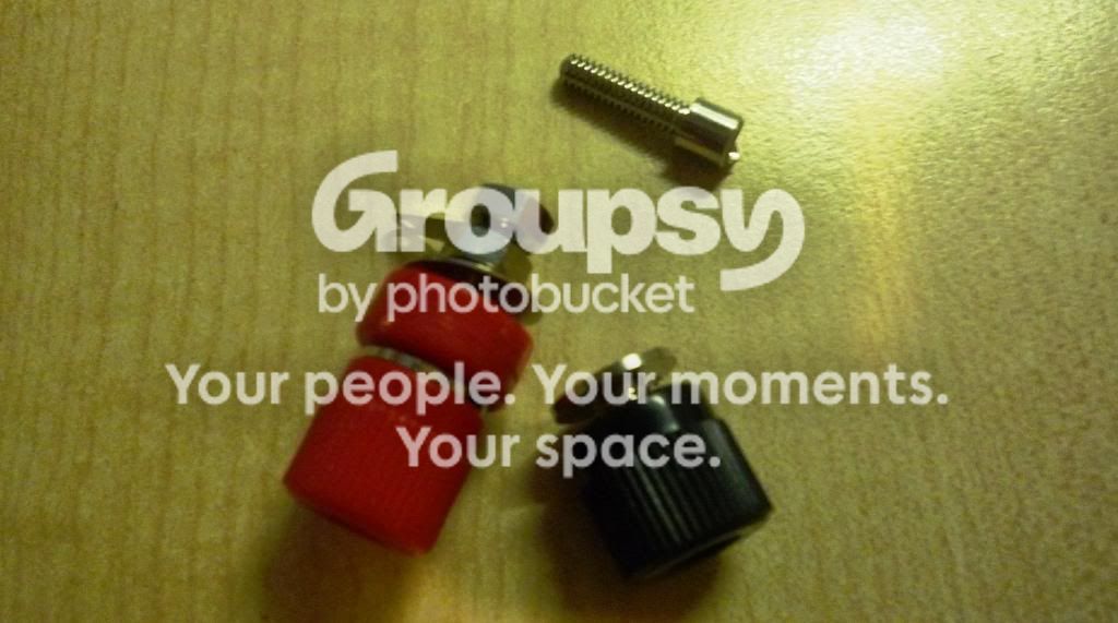

You need to be careful with tools, and try to don’t over tighten these binding posts,otherwise....something just snapped,and I do not know what it was :D
Being over-driven (clipping) or oscillation. :nono:
:yes: :banana:
:yes: :scratch2:
Seriously - Great Work Pepa - looks very nice now :thmbsp:

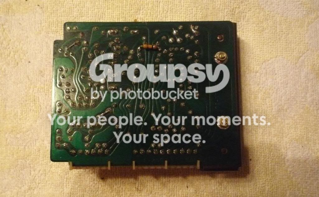

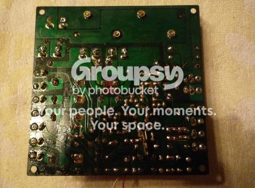

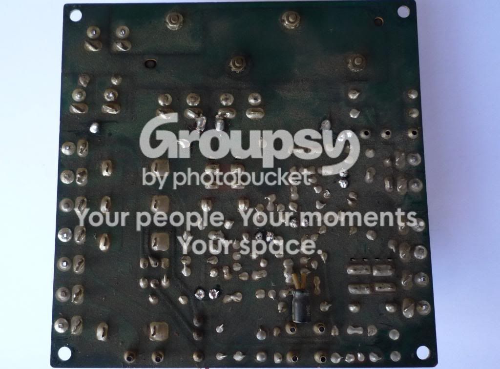

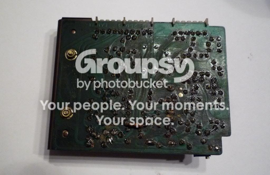

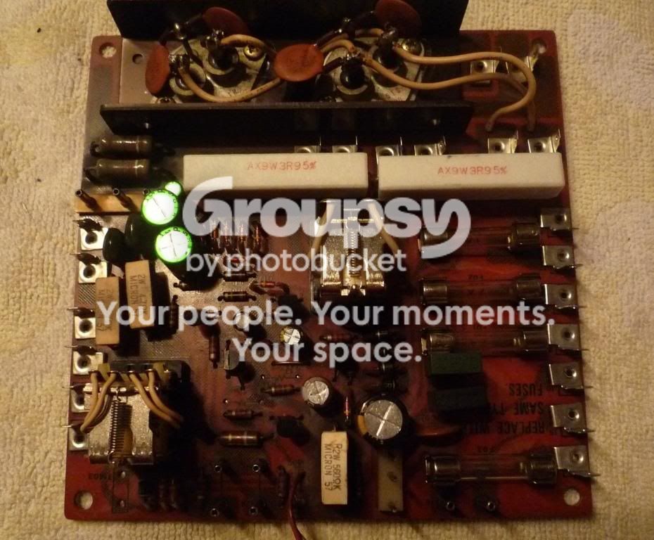

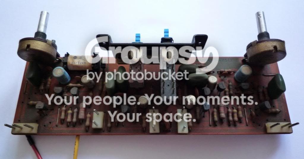

Tnx larry777....after all I've made ​​so far (all contacts and pots were cleaned,pcb were cleaned and resoldered,caps replaced,some diodes (vd1212) replaced with two in series 1N4148...) amp is working fine.
Only have one small problem...it takes 15 minutes for bias to reach his full value (20mA).At the moment I'm changing old thermal paste and insulators under the output transistors...we'll see after that (if the white smoke stay inside :D).
Perhaps the main reason for this behavior is missing plate above drivers pcb :scratch2:

tnx tobyj17....a little bit of plastic,a little bit of milling and that's it :D ...but I still can't understand the way some people treat their gear :no:

Man, looks like someone took a torch to it!
Yes Paul, it looks really awful

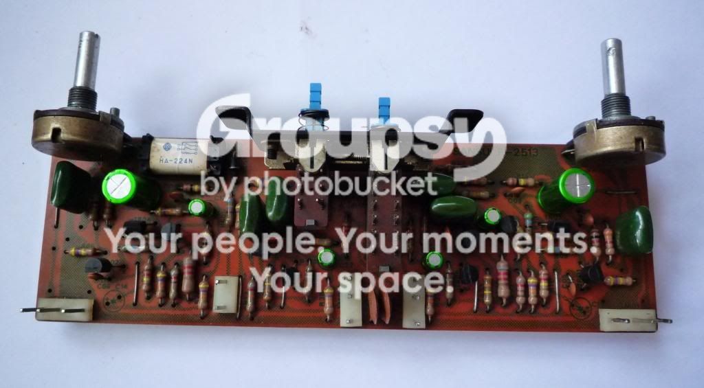

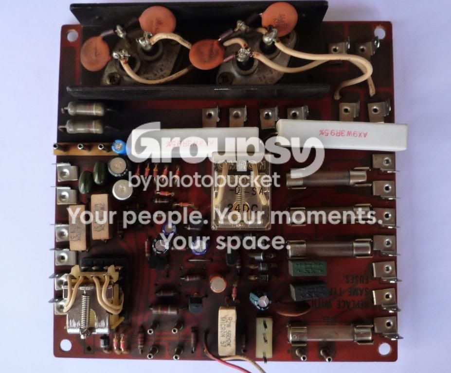

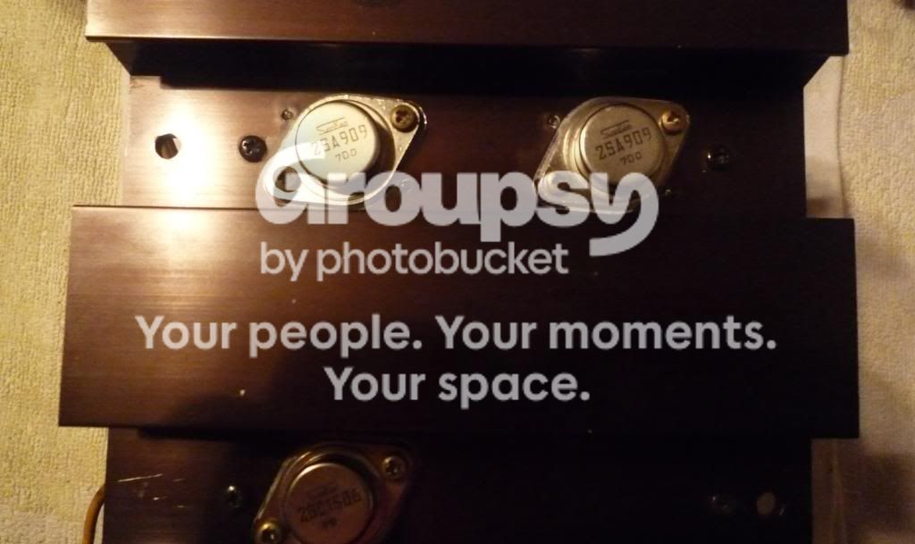

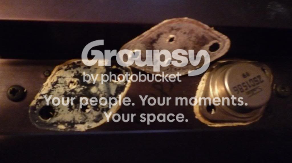

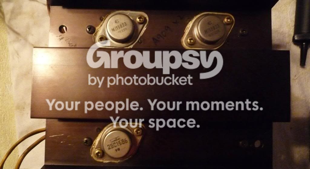

Transistors on one channel are original, while at the other...not
since I still have some NOS, I will replace them
thermal paste is not paste anymore,more like powder
All insulators were changed, dc and bias are OK,but... but still needs 10-15 minutes to bias reaches its full value (rising slowly) :scratch2:

Both channels? How bout some more pics of the work there Pepa....
Yes, both channels.
I have a feeling it happens if the amplifier is off for a long time (eg.over night)...on the other side,if I turn off the amp for half an hour,and then after turning on bias is normal.
At this point I am in the process of disassembling each pcb...again. I suspect at some cold solder joint or some connector...:scratch2:
I have a noticed couple degrees Celsius temperature difference between the sinks (at same bias; slightly but noticeable).

I think your 2SA909/2SC1586 are also not original, but good replacements.
Original is Toshiba 2SB554/2SD424.
Not saying this is your problem, but......
The board in between each heatsink has a boat load of pass-throughs that are known to cause problems.
My fix for this is to de-solder all, and then poke a small piece of wire through them, then bend it over to make a mechanical connection on both sides. Then re-solder.
This needs to be done.
Also, there are VD-1212 diodes all over this amp. They all need to be replaced with series pairs of 1N4148's.
Originals are 2SA908/2SC1585.....(according to the service manual). The 2SA909 and 2SC1586 are higher voltage equivalents, and Sansui may have used them in this amp also. Hard to say what the hell they do sometimes.....
Original power transistors at BA3000 are Sanken 2SC1585 2SA908 (Vcbo 150 V) but 2SA909 2sc1586 has Vcbo 200 V
According to the SM and general condition (screws,thermal paste...),they are original....tnx anyway
My fix for this is to de-solder all, and then poke a small piece of wire through them, then bend it over to make a mechanical connection on both sides. Then re-solder.This needs to be done.
OK Paul,thanks for the tip...I'll check that :thmbsp:
I believe I have replaced all these diodes
