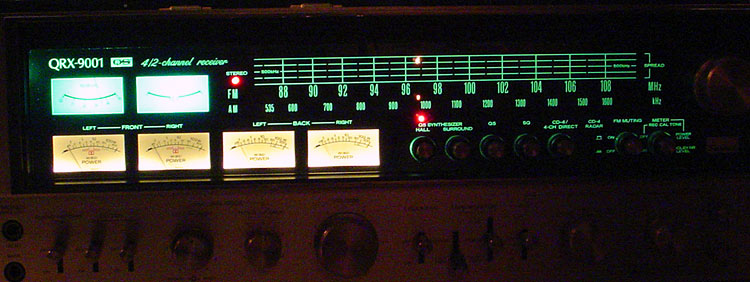

But man.... those meters ... just .. wow. In any case, mine is now restored and looks & sounds like a factory new baby. Really happy with it. But man. Those 9001 meters........
Just to feed your fetish and keep you looking ... <G>

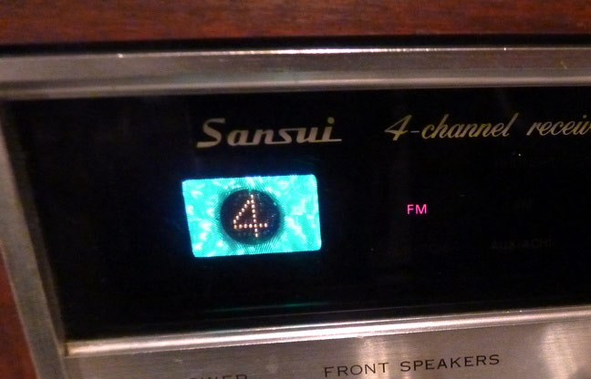

My usual go to to replace small value lytics are Wima stack films. If you cant find one that has the proper lead spacing, soldering them on the underside works. Nice work! Is that a nixi tube I see to the left!?
Proof positive old threads never die ... My rebuild was five years ago now. <G>
If you're talking about the 2/4 channel display on the front panel ... no, not a nixie (although that would have been kewl). It's a prism block with two wheat bulbs in it - one lights for two channel modes, and the other for four, and each lamp lights it's own layer. The back layer is lit by yet another bulb that gives the same background for both. Kinda neat really.
Sansui must have liked it ... they had the identical indicator in the QRX 6-7001's, just a different color.
Damn. That is really nice looking, no question about it. Those machines can be found in the USA with relative ease but over here nada. And those who come on the market are priced in the 'no sir, don't like it at all' range. People selling these machines know their money printers. Still, perhaps someday i'll find one on the attic of some old French barn ;-)
