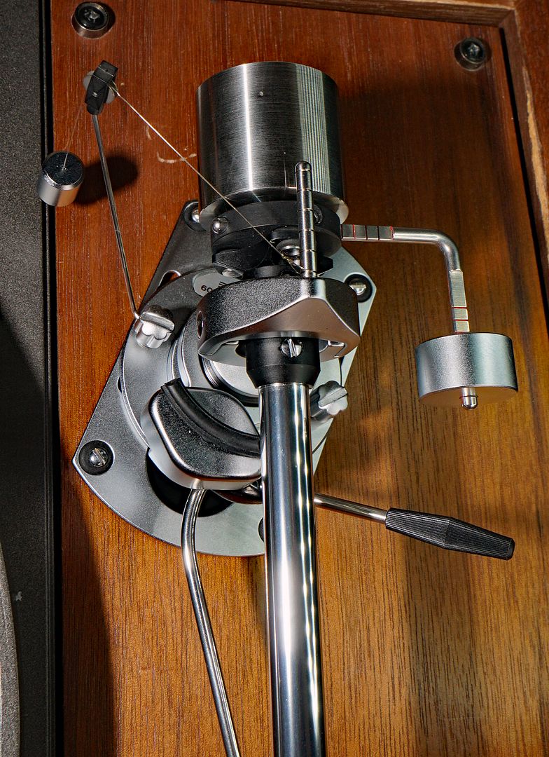

This is how the anti-skate weight hangs on the SME arm. Maybe it'll help you. :idea:
You'll note how the pole with the slots points in the opposite direction from yours. That's why the weight is on the opposite side, in the SME.

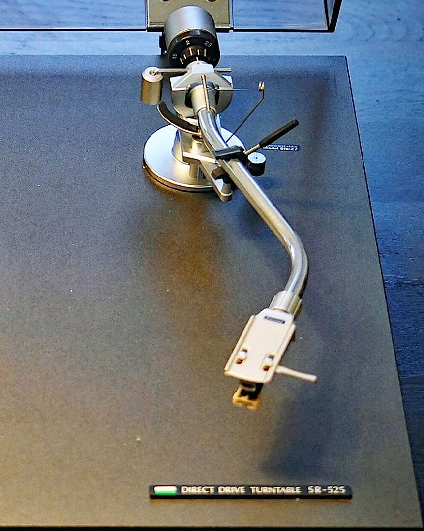

Is the piece's pin diameter similar to the size of the pole that has four slots on it (on the pivot of the toneram)? Maybe the small stub replaces that slotted pole?
Like the SR-525 arm? :idea:
It's possible, it looks like the slotted pole is removable; that 525 arm looks identical other than that. This weight was installed though and the slotted pole is still installed. It seems as though the nylon string on the weight is too short as well; by the time the headshell gets to the inner part of the record the weight is pulled all the way up to the little rod holder. I'm starting you think this wasnt original and someone just had it hanging there for looks. This one's really got me baffled! Maybe I'll by a proper replacement and get it setup and just keep this other weight as an extra for now....
