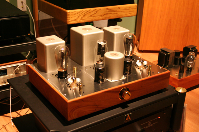

Assembly and wiring are moving along nicely and I think I should be able to do initial power up and burn in this weekend. A cool development for me is that my friend is building his version of this amp with the octal sub-assembly plate and using a Western Electric 717A pentode driver as used in the Yamamoto 45 that BrianB sells. It should be very interesting to hear 2 versions of the same amplifier (both using RCA UX-245’s) with only the driver tube/circuit differing, in one system, back-to-back.
The 417A triode tubes I’m using are on the left, the 717A pentode is on the right.

finally...
Wiring is done short of a few resistors and I'll be ready to power it up on the variac and check voltages tomorrow. I'll do initial testing and burn-in with a CBS 5U4GB blackplate rectifier and Raytheon 5842's and ST 45's. This amp has been a long time coming so I'm really looking forward hearing it.
Not running yet Dan, about to leave on a 10 day vacation and just ran out of time. Kind of frustrating seeing it sitting there soooo close...

Ok, I’m trying not to be too excited, it’s only been burning for a few hours, I know the sound will change over the next while and I haven’t used my good tubes yet but man, does this amp sound nice so far. This is my first taste of the 45 tube at home and I think I’m in love!
I only made 1 or 2 stupid, easily fixable mistakes with this amp and I suppose I learned something about layout and grounding from my first project because this one is dead quiet, no need to think about DC heaters here. Voltages are all good but I might want to reduce heater juice a touch – the 417 driver is 6.6v and the 45 2.7v – within 10% but I might want to be picky with expensive old tubes. This is sort of a necessary evil I suppose in Canada where the wall voltage seems a little higher than in the US and the James PT is wound for 115v.
Right off the bat, I like what I hear with this thing. Surprisingly to me, it does a better job in the bass than my 300B amps and isn’t too far behind in the midrange, treble is a touch softer but this seems to be imporving by the hour. The soundspace this amp projects with a good LP or SACD is pretty amazing and I found myself forgetting about the ‘sound’ and just plowing through the record rack to just listen to the music. It’s too early for me to say for sure but it really looks like the <2w output of the 45 is adequate with my 100db efficient Altecs, I really was expecting to be disappointed here but so far so good.
I’m happy and can’t turn the damn thing off; there are so many LP’s I have to listen to again. If things get even better with some burn in and tube rolling…damn, I love this hobby sometimes.

I’ve given the amp some time to settle in, moved up to my better tubes (RCA UX-245’s, WE 417A and National Union rectifier) and did the tweeky stuff like putting the Herbie tube dampeners on the 417’s and using the Yamamoto ebony feet from BrianB. Speaker wiring is vintage WE thin ga copper in a 4 conductor Litz braid from ThatchEar (nice stuff Thatch!) and IC’s are Final labs cotton covered copper to the Counterpoint pre-amp.
I am very happy with this amp and really don’t think I’ll touch a thing on it. Maybe it was the break-in time or the tube rolling but the treble has opened up and there’s a better sense of air and space happening now. I still think the 300B amps with WE tubes have the edge in the midrange but it’s probably a kind of euphonic coloration I like, the 45 sounds more natural and balanced. I’m still not really sure that I can live with <2w with the 100db eff. Altecs and the larger room of my new house will be the real test but for now, the power is enough.
The best thing about this amp (or maybe just the 45), is the way it connects you to the music and lets you forget about all the audio stuff. I don’t think I’ve enjoyed sitting back with my wife and digging through the record rack more than I have over the last few weeks. While listening last night, she told me that she likes the system so much now that the 45 and Altecs should really go on the main level of the new house, she says I’ll just have to build more stuff for the dedicated listening room downstairs :) . I like this development, maybe I’ll get to the Edgar horns I always wanted and that 76 pre-amp but you know, when it comes to amps, I’ll build another just like this one.

I finally changed something...
Enough has changed in my system since I first started using this amp that I decided I should experiment a little.
The new room is bigger, better balanced and has way less 1 note bass ‘boom’ which seems to have given everything a somewhat lighter balance. I am also experimenting with a new crossover design for my Altecs that smoothens out the midrange a little and extends treble a touch through the use of a compensation circuit on the horn. It seems to work as intended but it sometimes seems a little too ‘polite’.
I decided to bypass the level pots in the amp as these where intended to act as attenuators in a bi-amp configuration and I’m not there yet. In went some R470 Tantalum grid stopper resistors to bypass the level attenuation circuit. This provided too much gain, increased noticeable hum and sounded a bit ‘shouty’ and forward so I replaced the Tantalum with a Riken 1.2k resistor and this was more like it!
Bass is improved with the system taking on a more controlled and effortless feel. The bass is in better balance with everything else and cleaner now without the 1 note bloat of the old room. There seems to be more detail and a sharper image as well, gone is the overly ‘polite’ balance the new crossover seemed to bring on. I’m back to thinking less than 2w is just fine power wise if I get to use a tube as sweet as the 45.
It continues to amaze me how small changes in circuit, layout or components can transform electronics built with simple, clean circuits like low power tube SET’s. The pot that was bypassed here was a good one – an ALPS BlueVelvet in a Riken shunted configuration – but getting more stuff out of the signal path made a significant improvement. This has really reinforced for me the notion that simple is best.
