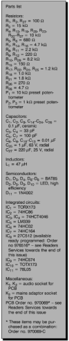

So I found this device called a Elketor Copybit Stripper that was manufactured some 15-20 years ago specifically so people could copy from a digital source to DAT. I found the schematics, PCB layout and BOM but I can't find anyone who actually has the PCB files to have the boards manufactured. Anyone know much about them?
I guess getting the EPROM contents will be the main obstacle.
