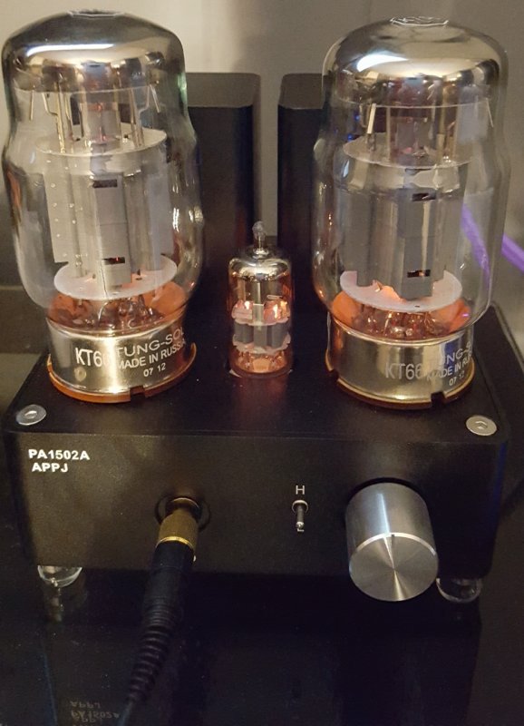

My home amp is an APPJ PA1502A with uprated coupling and cathode caps. Right now it's driving my HiFiMan HE-500s.
Wow! How gently does that design push those KT66s?
:eek2:
Most guitar amp designs that use two KT66s are running about 35-45 watts! Granted, they are striving for at least a bit of power tube breakup, but still!
:p
Wow! How gently does that design push those KT66s? Most guitar amp designs that use two KT66s are running about 35-45 watts! Granted, they are striving for at least a bit of power tube breakup, but still!
I'd say, "very gently!" The max plate voltage is only 210V. The APPJ originally came with 6P6P (Chinese military 6V6GT) power tubes and it still works best with 6V6 and similar. My favorites for power tubes in this amp are vintage T-S 6V6GTs and Mullard EL33s.
I got the Russian T-S KT66s lightly used for cheap. I bought them to prove 6L6s could be used in this amp - the T-S KT66s have the same heater current rating and similar ratings elsewhere as a 6L6. I can't use other KT66s because they draw 1.3A, which is too much for the APPJ to handle (max 1.25A for power tubes).
However, changing the coupling caps from 0.1uf to 0.47uf is the best mod you can make to the APPJ. The amount of sonic improvement, especially to detail, was impressive. It turned the APPJ from a good amp to an outstanding amp!
