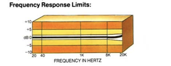

I notice a commonality across the first NINE cartridges in this ^^ 1985 Shure Catalogue ...
Frequency Response 20-20 Khz ("essentially flat" - wtf? Okay some are 18 Khz, 22 Khz) (***)
Channel Separation 25 dB
Channel Balance within 2dB
Tracking Force 1.0 gram or maybe 1.25 gram if it's not hyper-elliptical
Trackability - who gives a crap? If it's a Shure it's gonna track well...
(***) My hearing according to YouTube test-tone playback is 20 Hz - 13.5 Khz so I need not worry about the difference between 18 Khz and 22 Khz cartridges!
So why did people buy a V15 Type IV-MR? Was it a status thing?
Why not just get an M75ED and laugh all the way to the bank?
Do you buy a higher-end cartridge mere to gain access to higher-end styluses?
Did Shure NOT use +/- 3dB standard frequency response bands for its frequency reponse ratings? I understand that m97xE (which I own) has a treble roll-off much higher than some other cartridges, but it does NOT seem to be reflected in the published specs ...
Is there an expectation that higher-output cartridges have a better S/N rating? In that case I win because I most often play an M55e which is essentially equivalent to M80 with a 9 mV output....
Why? Refinement.
Yes, the quick specs all showed similar ratings, but they didn't include such things as cantilever resonance points, polish of the diamond,cantilever material, laminated cores and the other things that bring out more detail, contributed to a neutral sound, enhanced soundstaging and...yeah...trackability.
(Sorry but I do give a crap about trackability. Shure's lower end cartridges did track well, but the V15 V-MR tracks superbly. I've heard many a lower end Shure or Pickering cart that while technically didn't mistrtack, still, the sound was a bit sharp or let you know you were getting close to the edge.)
The M75ED might look as good as a V15 V-MR, on paper, but what about the higher mass of the cantilever that put it's resonance point in the audioband that necessitated a capacitance loading of over 400pF to flatten out the response? And even then, as flat as it made it, there is some consequence to the sound.
If you like the M75ED...great! It's a classic cartridge. But there were reasons.
We all know specs are numbers.
Regardless of the “numbers”, these different carts *sound* different! They are constructed differently!
The M75 is very different from an M95. 95 is different from the 97, which is different from the V15-4, which is different from the V, which is different from the V-MR, which is different from the later VxMR.
“Shurely”you’ve learned by now that specs don’t tell you how something sounds?
If you were to listen to the M75, then the M55E, then the M95, then the M97-E4, then the V15-IV, then the V15V, then the V15V-MR, then the V15VxMR, then the M97xE, you’d fully understand that specs don’t tell you how something sounds. (I have all of those carts mentioned, plus many more Shure carts, with original styli. In fact, you’ve only barely scratched the surface with the M75 and M55; those are both the same cartridge!)
Frequency response and tracking force don't tell the whole story - https://audiokarma.org/forums/index.php?threads/vintage-shure-stylus-tip-shapes.783833/
And there are more differences than just the stylus tip profile - the resultant weight reduction in the tip plays a part, plus different cantilever materials and improvements to the suspension over the years to allow lower tracking forces and reduce wear while maintaining the same (or improved) trackability. The Shure N140HE stylus, for instance, has a beryllium cantilever.
