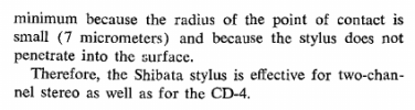

You say so! The science tells another story. Shibata was developed for CD-4. And defeated / outclassed all other so called developed for CD-4 styli icluding Philips SST microline tips.
Shibata: patented 1973 by JVC
Micro Ridge: patented 1985 by Namiki
The explanation regarding why the Shibata needle tip was developed was exposed by Norio Shibata of JVC here:
Microline has an even larger area of contact and an even smaller radius of contact. Therefore, all the benefits of the Shibata needle for CD4 playback are also satisfied (and in a greater degree) by the Microline needle.
