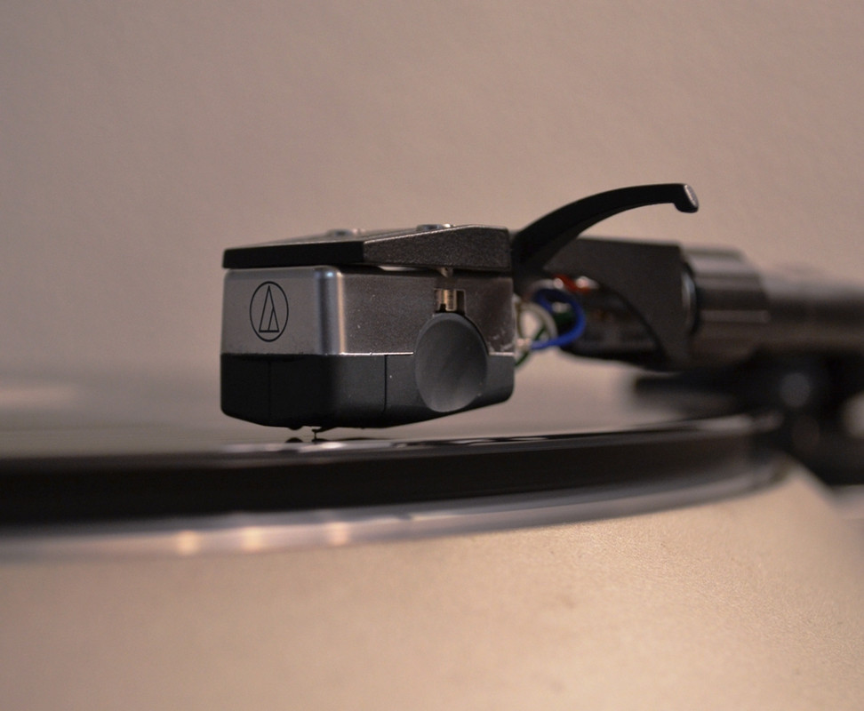

I just picked up a vintage Signet TK5E cartridge last night. It came with the original Signet TKN1 stylus (0.2 x 0.7, nude, square shank). Unfortunately, the suspension has gone soft. Even with the VTF set at 1.0g, the plastic body of the stylus rubs on the surface of the record being played.

MCM_F: If you haven't yet, you might want to try, whether you can shove the cantilever assembly farther into the plastic holder after opening the so-called compliance adjustment screw - and then lock it again. That might work, unless the flexible filament between the frontal and the rear par of the cantilever assembly has actually ripped, which I'd deem rather unlikely, though - more usually just the damper ring has shrinked a bit, so that the intended tension isn't there anymore. Another method would be to cut out a little U-shaped piece of thin, but stiff plastic foil and shove that with the closed side up between the plastic holder and the damper ring.

Manfred / @lini , I finally worked up the nerve to attempt this. It was actually much less daunting that anticipated. The surgery was a success! The patient lives:
Tracking beautifully and sounding amazing at 1.2g.

I used the first method you described. Upon further examination, the cantilever assembly had slid forward and there was a tiny gap between the rubber damping ring and the plastic grip. I loosened the compliance setting screw, removed the cantiver assembly, reinserted it and made sure the damping ring was snugged up against the plastic grip and re-tightened the screw.
Someone on vinylengine posted photos of transplanting the cantilever assembly from an Audio Technica AT13Ea into a Signet grip. Once I saw the simplicity of the design of the cantilever assembly, it was a piece of cake to do this minor surgery. I think this Signet is a keeper and given the scarcity of NOS Signet styli, I will keep my eyes open for reasonably priced Audio Technica styli to serve as potential future donors.
