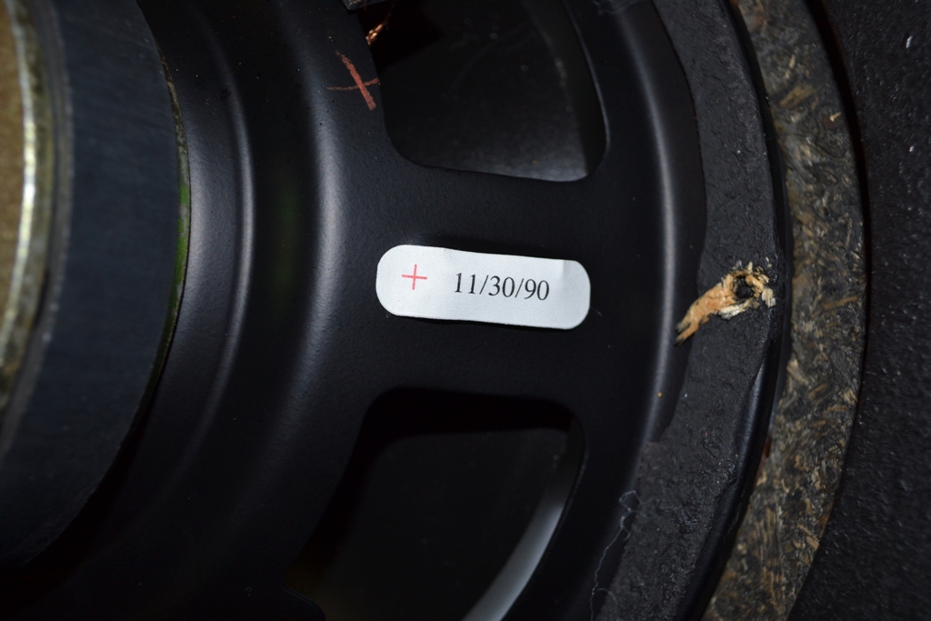

Picked up a pair of Snell Type K/II today. The foams are shot. I've done some research on these and it looks like most used woofers from either Vifa or Peerless, but there are also mentions of SEAS and Boston Acoustics woofers being used.
I removed one of the woofers, expecting to see some type of identification, but this is all I got:
I've found photos of the backs or the Peerless woofers online and they do not look like this. Anyone recognize these? Are they the Vifa woofers, or maybe SEAS?
I know, from my research, that the Type K/II were made from 1989 to 1995 and that "early" samples used the Vifa woofers and "later" samples used the Peerless woofers. Would the 11/30/90 manufacturing date qualify these as "early"?
I've read that the best foams are available from Audio Note in the UK, but I'm not sure if they sell sell foams for Vifa, or Peerless, or both? Their price list only lists FOAM SPEAKER SURROUND K-TYPE, but doesn't say which woofer it fits. I've also read that the Peerless foams are the hardest to source. So, if these are Vifa woofers, can someone recommend a good source for replacement surrounds?

Boston Acoustic woofer. Be sure to use filleted surrounds.

You bet! The design of the date sticker and the shape of the magnet gave it away as BA. Heck of a Goodwill find.
Just ordered 4x - Filleted 8" surround (for 6/6.1" cones) is p/n #610-365/baf-1 from Rick Cobb. I'll do the HD8s first for practice and then the Snells. I've already removed the old foams from the HD8s and cleaned up the cone and frame. So, they are ready to go. While those are drying I'll remove the old surrounds and clean up the Snell woofers and get then ready to go.
