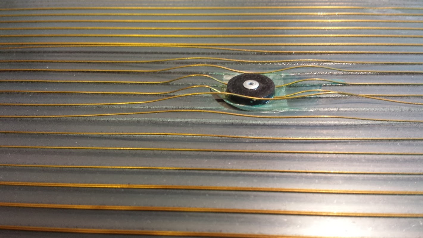

This whole situation at the center bothers me.
FWIW magnepan recommends driver replacement in any case where the membrane is torn. Perhaps they just replace the membrane and wiring? Since the magnetic structure is still good.

It's the stretched wires that have me paused. It seems like there is a couple mm of slack to take up in a few of the wires, where they were bulged out around the button.
One thought i had was to strip the glue and lift them all the way to the top of the driver, and then lay them flat starting at the button and advancing toward the top. This shouldn't be harder than laying down any other loose loop of wire, right? And the end of each loop is basically inactive, since it is too far from the magnet to begin with.
