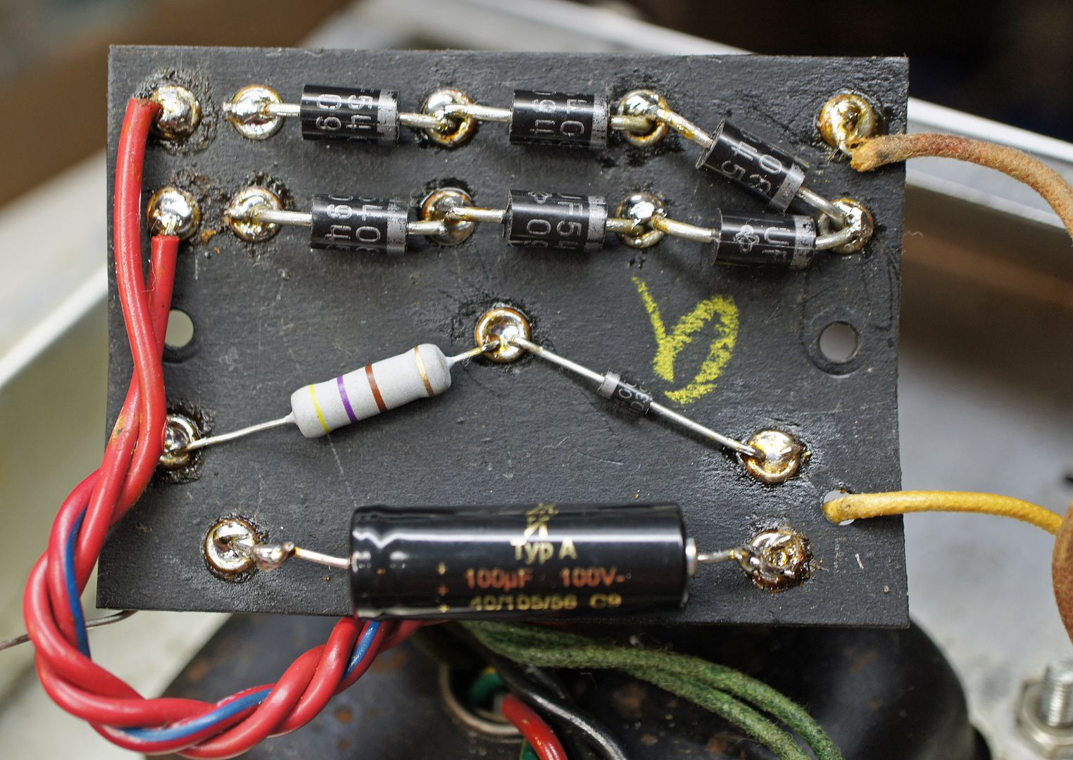

My Weller setting for point-to-point, eyelet-board, or turret-board tube circuits. Using 0.05 or 0.093 Kester "44." 379ºC = 714ºF.

Too hot just wrecks tips. I've had wire braid get old and oxidized to the point where you can barely solder it. You don't want to use any kind of acid flux paste because you'll never clean it out of the braid and it will corrode forever. Rosin only. If scraping it with a knife or using steel wool (watch for stray pieces that want to make short circuits) or fine sandpaper doesn't work, it might be time to find new braid.
Something I learned not all that long ago. Never use water-washable flux with stranded wire, especially near anything fine pitched. It wicks up the wire and never gets washed out, causing failures later. I like Kester solders with 331 washable flux, but only for new PCB construction where you can really wash it. Should never be used for service, especially on stranded wires. This isn't theory or FUD- I've seen it happen!
No, rosin isn't water washable. The washables are organic fluxes very popular for commercial assembly. You'll often find "no-clean" flux, which is basically minimalist rosin and water washable, which can be corrosive, conductive and HAS to be washed within a day or so of soldering. The upside is it's very easy to wash off and gives you a beautiful clean board. See 331 Flux-Cored Wire for a water washable. They also sell liquid fluxes, both types, but in quantities far larger than any hobbyist needs. I still have a bottle of rosin flux I got decades ago and in all those years it's nearly full. The old stuff really did smell like pine trees!
