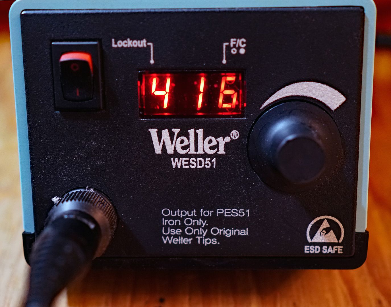

Way too hot for anything with 60:40 and even at the top end for some lead free. You'll just burn tips, vaporize flux and generally make a mess of components and joints.
350C (662F) is the top temp with 330C (626F) quite usable for most people and small traces/lands.
I use 350C and rarely ever need to go higher.
I always run mine (Pace ADS-200) at 800F. Anything colder is too freakin' slow.
Mine typically runs in the 700-750F range, basically wherever I left the control last time I moved it. Its not a digital and those two points are fairly close together on the knob. I've not found it to be a particularly fussy value.
I'll crank the temp for turret boards. You want to get those right the first time. 416ºC = 780ºF.
Do you have a thermocouple digital tip thermometer (calibrated)? If I need more heat (for a large thermal mass joint) I move up to the 120W iron (same temperature).
I guess if you're doing a lot of large tag-strip heavy gauge copper point to point you might need >100W but it's super rare to need a temp anywhere near 400 degrees C. Your tips will burn in front of your eyes. Put it this way, I still have and can use the Hakko tip that came with the first 926 station I bought in the late 1980s. Sure I've replaced it, but it's serviceable, still.
350 C (662 F) for me, is the upper limit for 60:40, unless it's a huge ground plane and even then 370 C would be the limit. A >120W watt iron eats that without thinking. LeadFree is a whole other sh#tfight and if that's what you're referring to, OK.
Hot-air rework at 750F (400C) is at the top end for PbFree in my lab.
But I have to agree, a high temp for us guys who have been soldering since we were 7 years old is not a problem. That said, I like my tips to last.
I've found cranking the soldering iron to 750°F works when needed. Ain't nobody got time for anything else. Oh no, you might burn your $15 tip; has not happened to me yet, and if it does I'll get new ones from hakko.
That said for OPs problems, more/better/more aggressive flux is likely the answer.
I seriously doubt the OP meant 750C. 750F is fine for medium to larger connections.

Assuming that's 750F, the temp is a bit high. My Xtronic unit is set at 375C. I found that I pretty much have to clean the tip every 2-3 joints or oxidation makes tinning poor or non-existent. Either the brass Brillo thing or wet sponge work fine. If temp is too low, time to melt involves a lot of heat soak, easy to fry components. Copper plated aluminum wire is terrible; if you get it to solder, it breaks, bad stuff. Pure aluminum, forget it, wire wrapping and glue. Old green wire, soak it in IPA, then Deoxit, it can be cleaned well enough to solder. Toothbrushing required.
FWIW, when I worked in med devices, techs, who had good technique, soldering teeny weenie stuff all day long used tip temps of 750F. Soldering technique is as important as other factors, takes some time to develop.
Your solder is fine, doesn't matter much, anything with specs is OK.
