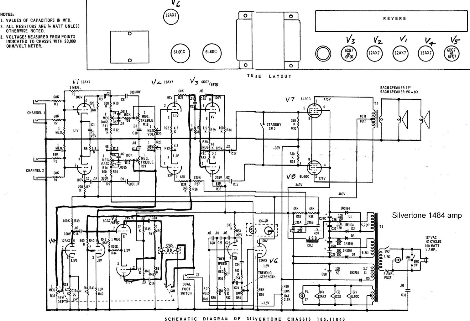

What tubes are used, and could you post a schematic?
Dōmo arigatōgozaimasu!
Input stage: 12AX7 (1/2 per channel)
Gain stage after tone controls: 12AX7 (1/2 per channel)
<both channels are mixed together here>
Gain stage after mixing + cathodyne phase splitter: 6CG7 / 6FQ7
Output stage: push-pull 6L6GC, fixed bias
Applicable to channel 2 only:
Reverb stage uses 12AX7 (amplification) + 6CG7 / 6FQ7 (driver duty).
Tremolo circuit uses 12AX7 for the oscillator.
Full in-circulation reproduction schematic I mentioned attached.
Found this schematic on the Net. Someone made annotations in the Reverb and phase inverter sections. By chance, do you have the mating cab?

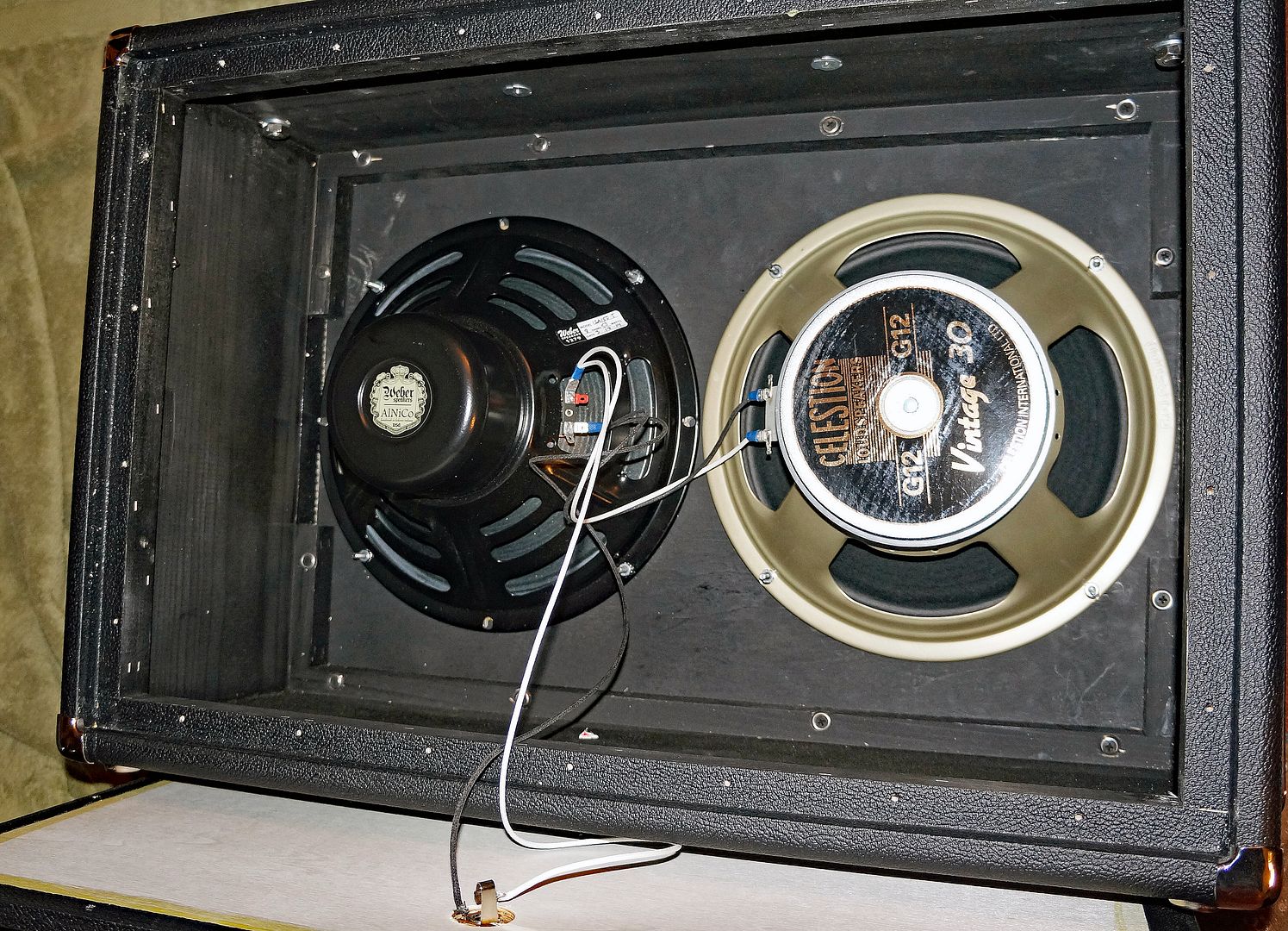

If you don't mind me asking, what speakers are loaded in the cab?
I DIY'd a 2x12 for my Bassman. One Alnico Weber and one Celestion Vintage 30 ceramic. A pretty unique tone.

The output section is pretty normal. Starting on the left, we have a 6CG7 acting as the driver stage. The upper triode is a gain stage and the lower triode is a cathodyne phase splitter, both built in the simplest way possible. The gain stage is necessary because a cathodyne phase splitter has a gain < 1 (usually around 0.9; sorry, I'm not going to do the math to calculate it as built here :cool:), but considering the 6CG7 is a low-mu tube and lack of a bypass cap on cathode, the overall voltage gain here isn't going to be terribly high -- maybe roughly 13 after phase splitting?
Note the error in the "original" reproduction schematic -- the junction dot where the 3 resistors meet in the lower triode (phase splitter) is missing. I've added one in red here.
Also note how the standby switch is implemented in the 1484. In classical Fender amplifiers, standby switched the main B+ rail, the intention being to prevent over-voltage on the power supply caps while the tubes are still non-conducting during warm-up. Unfortunately, this isn't great for the tubes or for the switch. If left in standby for too long, the tubes in a Fender amp will be subject to cathode poisoning, and having high voltage present on the switch pretty much guarantees arcing inside the switch when coming out of standby, thus shortening the life of the switch.
The 1484's standby switch is completely different, and is designed merely to mute the output stage. It does this by shorting the two output phases together, cancelling them out. Because of the power supply's design, it's not possible for the caps to experience an over-voltage situation during warm-up, so there's no need to protect against it. I suppose another nifty little side effect is that the standby switch can be used to check if your phase splitter is running out of balance :).
The output is a push-pull pair of 6L6GCs, Va=475V, Vg2=340V, Vg1=-36V, which should be roughly 26mA of quiescent plate current and around 12.5W of quiescent plate dissipation. Danelectro biased these tubes on the cool side for sure. The bias is not adjustable, and I don't intend to add any adjustment capability. Again, my goal is to run this amp is it would have run from the factory.
The output transformer has a 7.6K primary and a 4 ohm secondary. The OT is fairly under-sized, and saturates when the amp is being driven hard. I assure you, this is part of the charm of these amps.

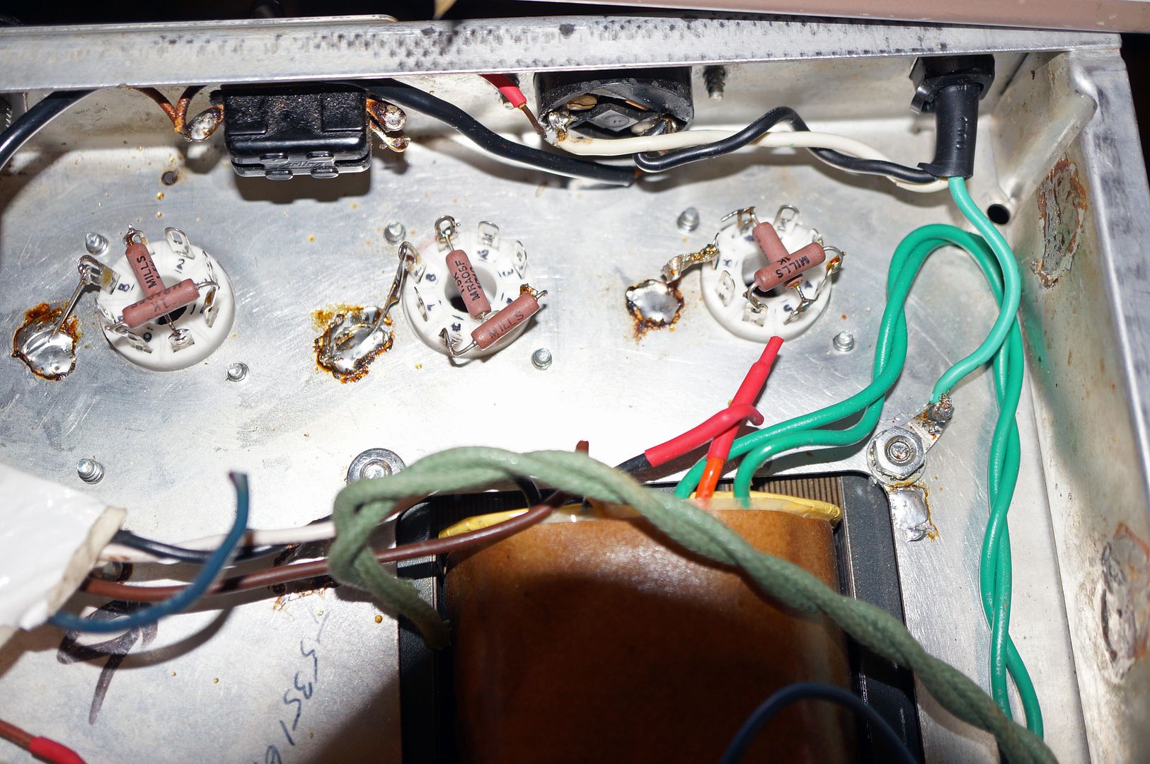

Just put in the grid stoppers and screen resistors on the 6L6GC, check the nominal voltages, and I think that you'll be good to go.
BTW... I'm sure you already know this. But Fender put those resistors on the tube socket to minimize lead length (and potential inductance-induced instabilities). Choose ones that have good heat resistance.
Mills wire-wound resistors have good heat resistance and low inductance. Grid-stopper resistors are soldered across unused pin #1 and control grid #5. Screen resistors across #4 and unused #6. Then solder the input signal to #1. And the screen voltage tap to #6.
