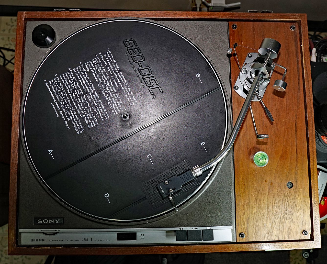

It's cut into the board. You'd need to put a wooden plate over it, with another pre-drilled oval.
Ah ok makes sense. So whoever cut my armboard botched it im guessing.
Or it's set up for another tonearm. The one on mine is thin 3/8-inch plywood. It would be easy to fabricate a couple with different pivot points and/or slots for different arms.
You need to follow the arm manufacturer's template to get the best range of adjustment.

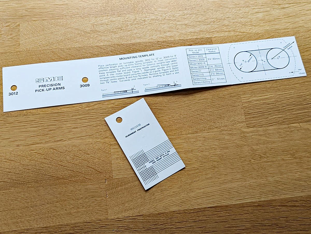

Oh that part i know. But to spec it to the exact distance pivot point to the platter has to be precise.
Most tonearm companies have 1:1 templates you can follow (or find online). It doesn't have to be to the 0.1mm, but the closer, the easier it will be to do the node point adjustments.
For my 3009, I use a slotted Sony headshell (its mass is well-suited to my MC cartridge). I coarse-adjust the arm's length with the built-in SME adjustment. And do the final fine adjustment using the headshell's slots.

I also forgot to mention that when i bought my PS-2251 the guy threw in this armboard. I believe its for an SME arm although im not sure which model. But id be willing to buy an SME arm to put on this table. Its that good. Anyone know what possible arm could have went with this board?
It is for any SME tonearm.
Sometimes the cut is done in that way, not "slanted".
I have had two turntables adapted for SME where the oval was set up vertically, like in your example.

This is the template that I used. I couldn't get the arm to 90 degrees because of interference with the metal chassis in the Sony. With a slotted headshell, both Baerwald and Lofgren B can be set. I haven't tried Stevenson.

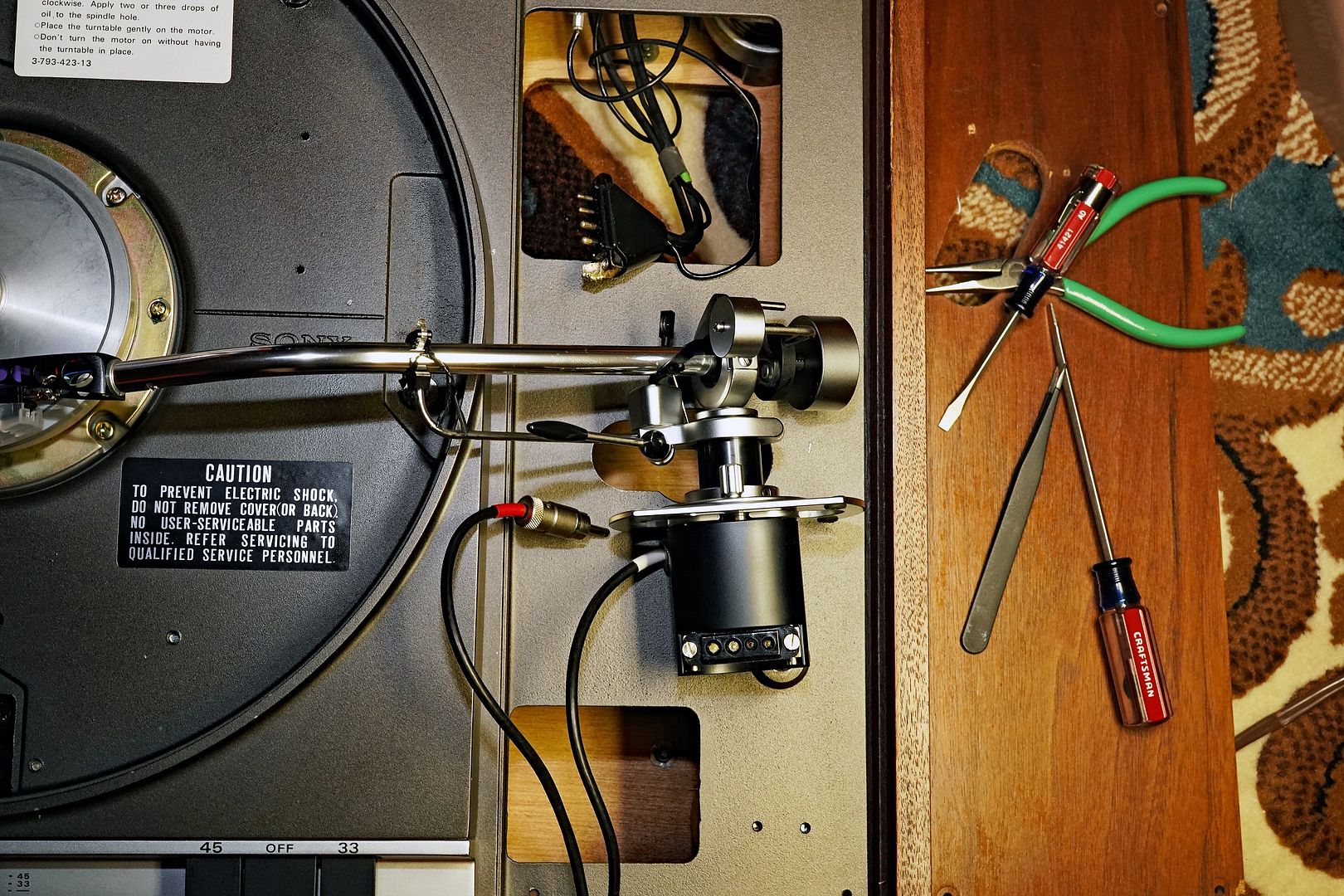

My "new" 2251, with Rabco SL8e linear tracking tonearm. Filthy and sad.
And a big shout out to Mr Boochie, his excellent photo sans arm board at the beginning of the thread confirmed that I cannot use a long tonearm without metal cutting. Thanks so much for saving me a lot of grief.
I have zero experience with that Rabco arm. To make it 100% reliable would be a whole new learning experience for me.
Good luck with your Sony!
:thumbsup:
Oh, I am only going to touch the Rabco to take it off. Wanted to put an 11" Grace G860 on, but your excellent photos showed me that was a non starter. Thank you. So plan B is to put a 9" Grace G940 on it. It's going to all work out as I have had a London/Decca Gold cartridge sitting in it's box that I have never heard. It is a very arm sensitive cartridge, but is reputed to work well with damped unipivots. Let the adventure begin!
