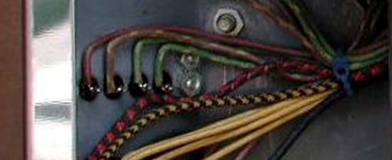

The wire should not go under the screw head as shown. The wire should go under the metal plate below the screw as this plate has the actual wire from the output transformer soldered to it, inside the amp. You may have to loosen the screw and lift the plate up with a small screwdriver, then place the cable below the plate and screw down. Much better connection.

Not my setup but good to know all the same. I did not realize the plates under the screws could be lifted in that manner.
