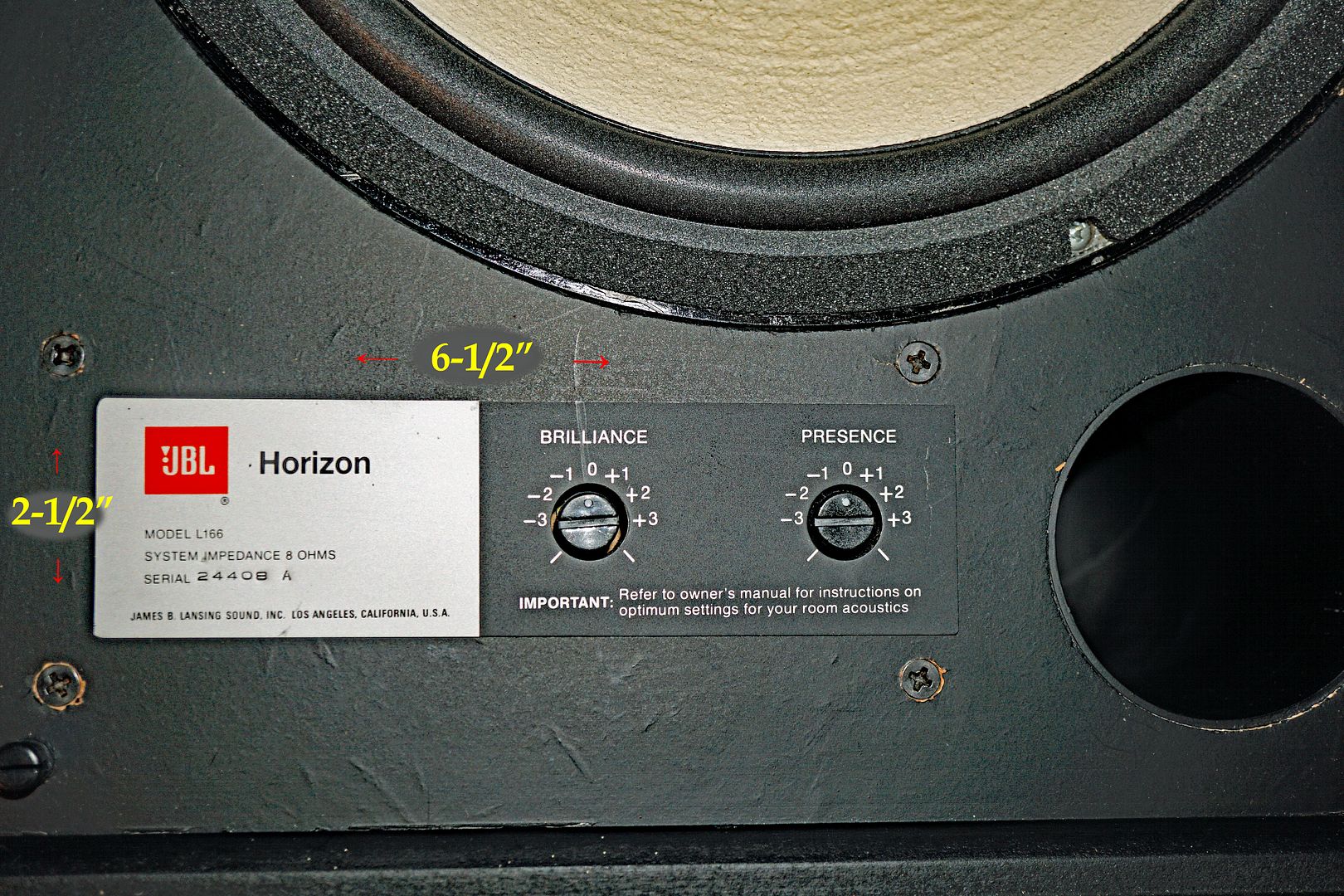

Good luck with the speakers. Before starting, I have one suggestion — as a possible option. :)
The L166 is a better speaker. :thumbsup:

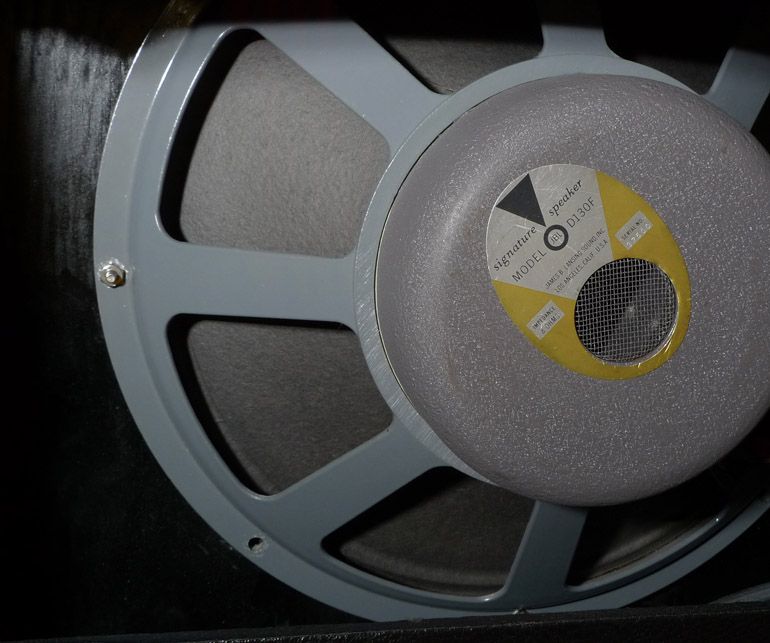

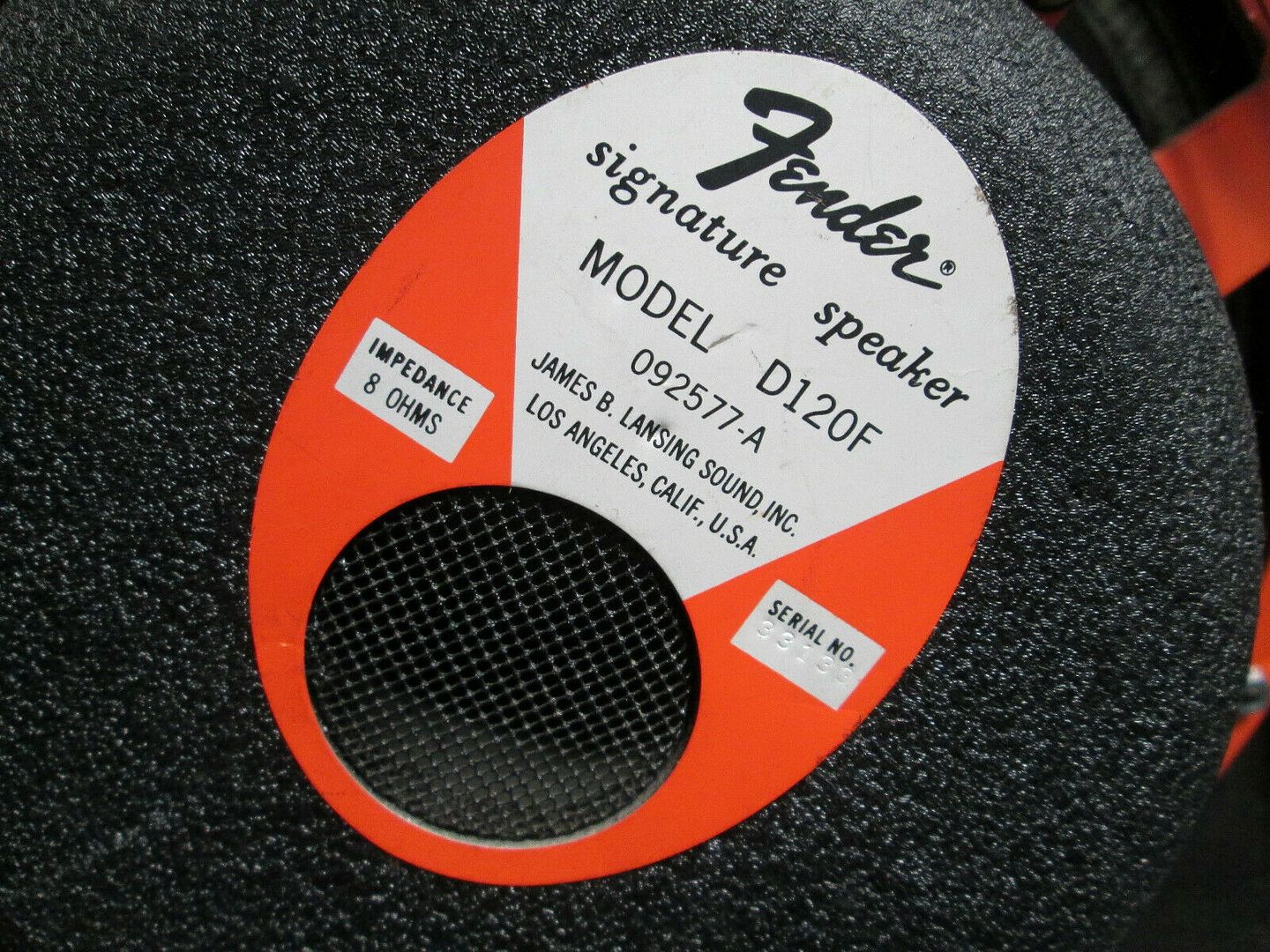

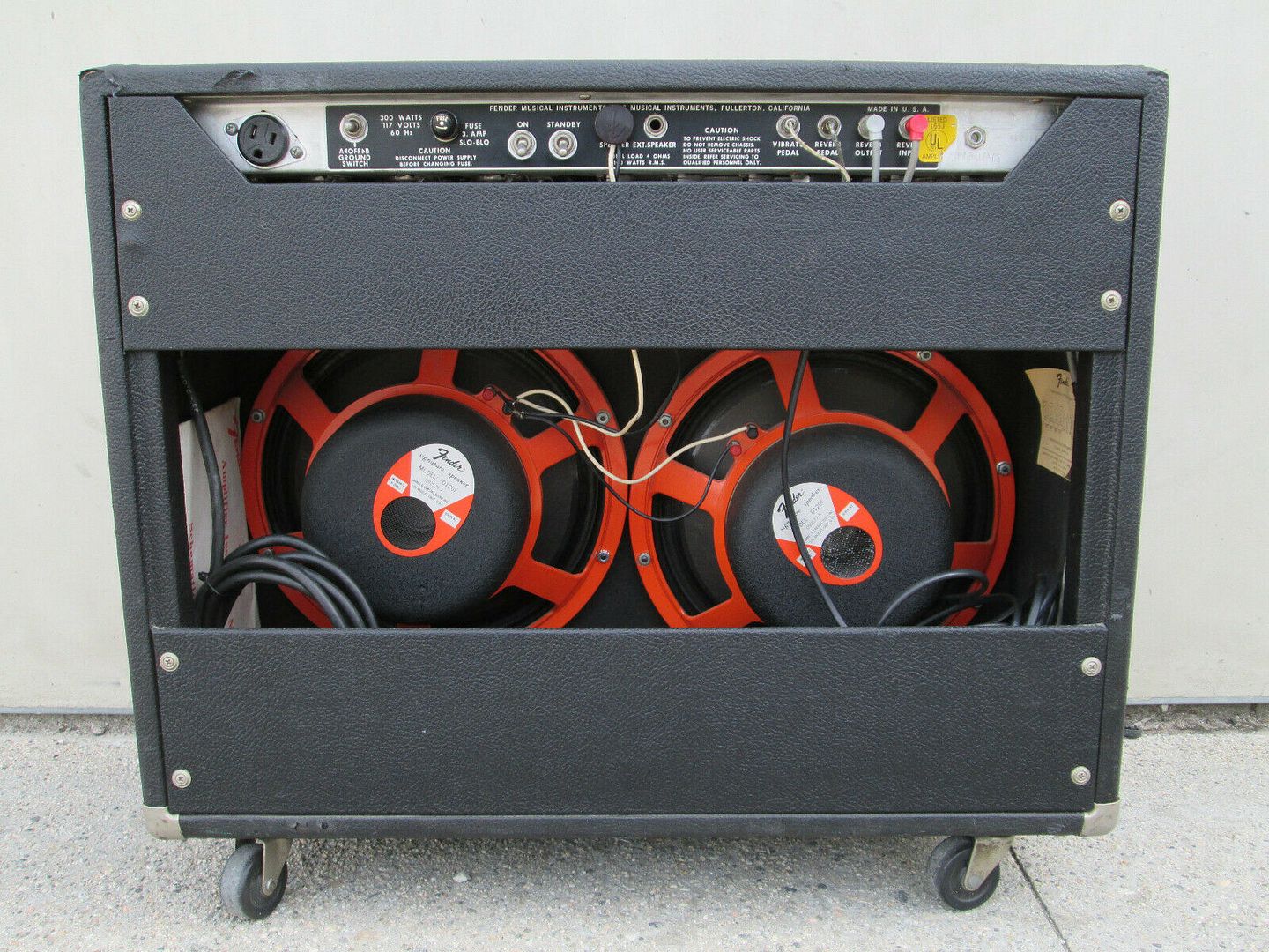

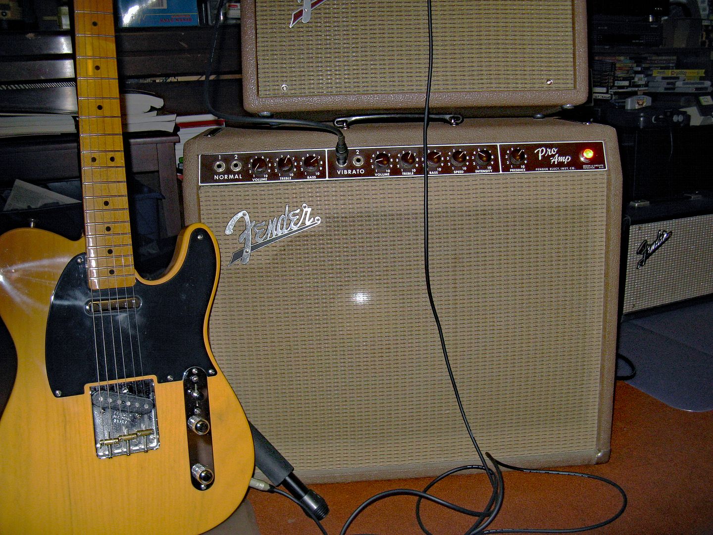

The earliest JBL speakers that I have are in Fender amps.
