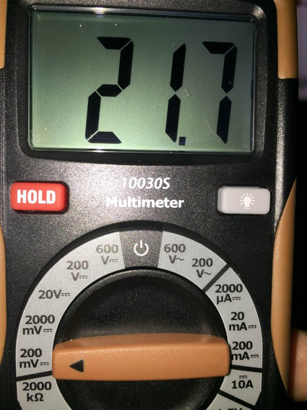

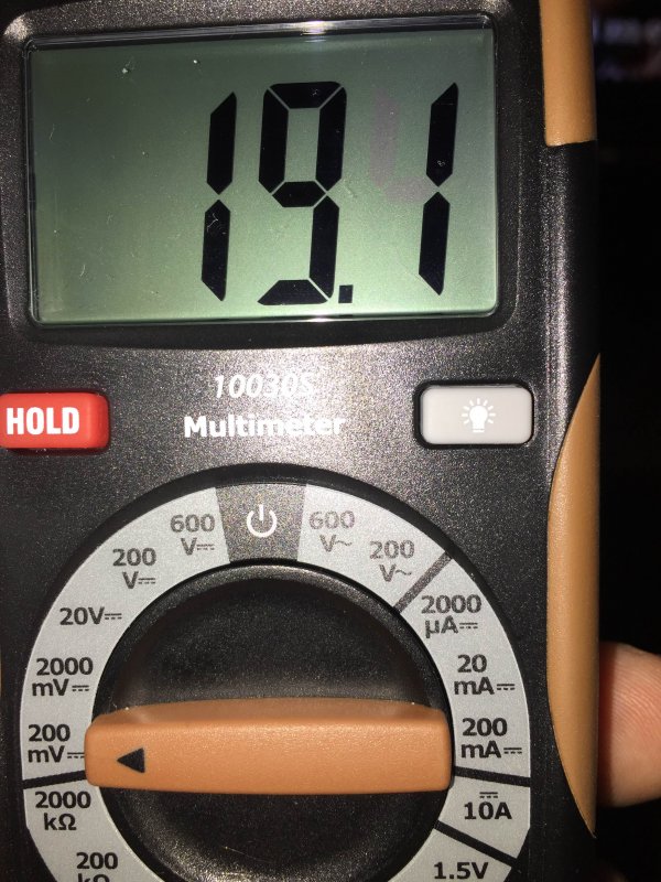

If you do not have a meter the easiest way to check for offset is to turn the speaker switch on and off with the volume all the way down. There should not be a "tick" sound. You can start to hear it on most speakers at around 100 mV faintly. At 250 mV which is considered by most a hard limit, it will be more noticeable. If you can get the grills off the speakers, if you see the cone move more than like 1/16 th of an inch, I would be concerned.
For the moment you will have to risk a good speaker on that channel to do it, but it is about the fastest way to find out. Speakers usually do not just go bad at low levels unless it is the foam disintegrating. (I think even that is accelerated by driving them hard)
But I agree, quite a coincidence to be the same channel. You might have intermittent DC offset. It happens.

I'm sorry, but I don't quite understand you here. Turn on the receiver, play the radio (for example), keep the speakers plugged in and then check DC?
