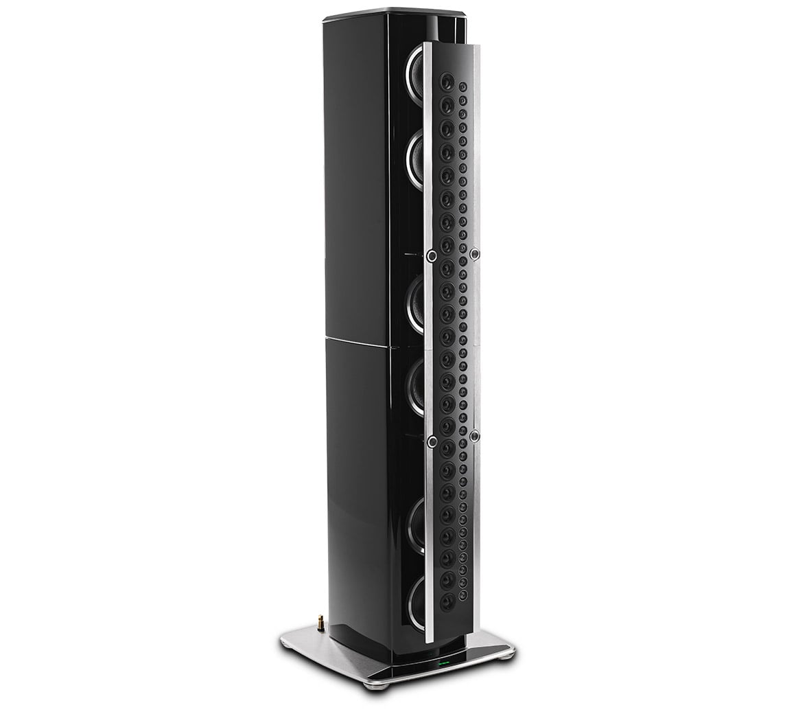

Do you think the above McIntosh 70 driver speakers have any in Series?

All of Rogers designs were in Parallel I think. My concert Grands were a special variation of series parallel. So if one woofer failed the other three would keep working. But I rewired them all in parallel and the bass was extended and became more efficient. Neither my 7200's, MC 206 or MC 207's have had issues pushing 2 ohms. but only for 2 channels with crossover at 250 HZ as the system was tri-amped. the XR 290 the woofers were in series parallel.. I don't know what the K series of speakers with multiple woofers do. Altec made special diaphragms and woofers with 32 ohm impedance for their very large Movie theater Speaker systems with 4 515's in parallel back in the days of tube only. I know when driving the big EV sub woofers in discos if we wired them in series to keep the QSC amps from over stressing the bass performance fell off around 45 HZ and the levels dropped. So we ended up having to add another stereo amp to push the subs which reached down to the mid twenty hertz range . Each box could handle 500 watts RMS. Same thing for Altec and JBL subs.
