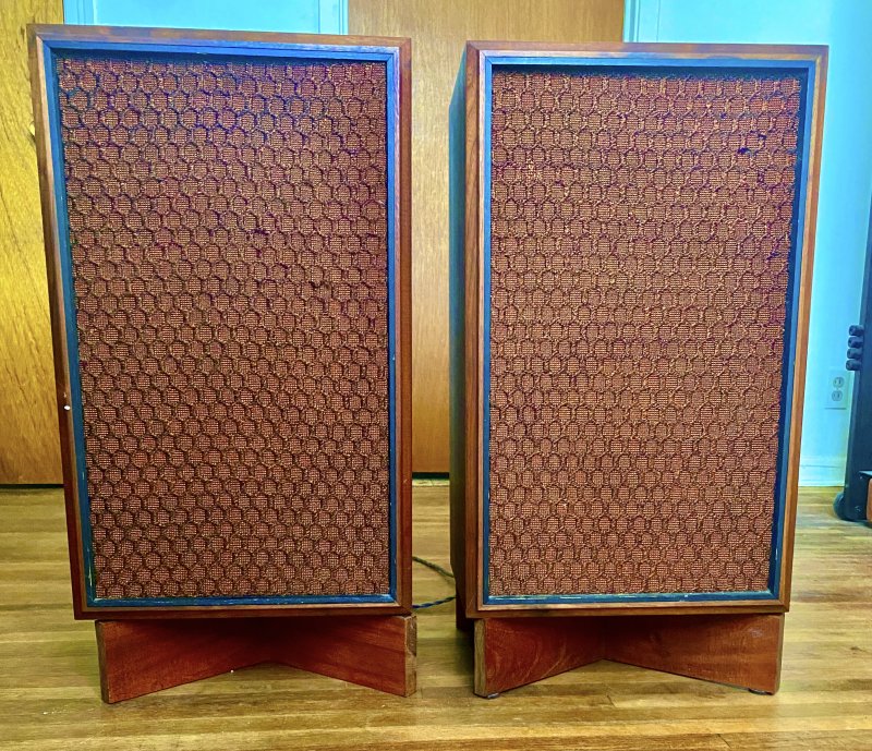

The model speaker you and I have are the M-400 Ambassador. Here's a shot of mine.

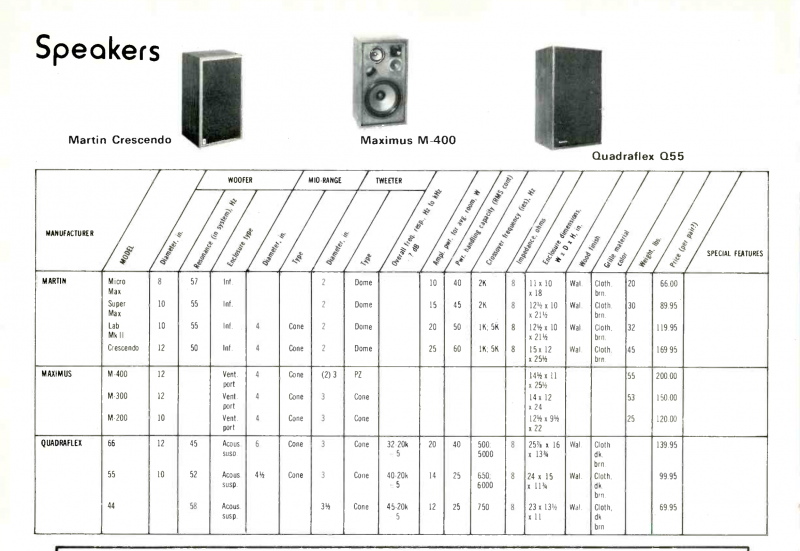

The Below image is a Specs sheet and comparison.
