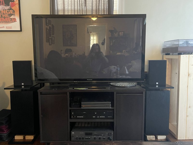

Ok so quick update, mostly just in case anyone else ends up needing info on these brackets.
I've reached out to tons of different audio specialists asking about these and no one (other than the fine folks in this thread), including KEF, have any information for me. Also, after months of searching, I still cannot find record of a single pair of these being sold.
I initially was going to just buy some stools to set my C15's on so they arent in direct contact with the subwoofers, however, while searching, I stumbled across some side tables i think will work even better.
Just placed an order for two of these: https://www.amazon.com/gp/product/B086Z7LFBB/ref=ox_sc_act_title_1?smid=ATVPDKIKX0DER&psc=1
From the dimensions, im thinking the subs will fit in the bottom part and the c15 will rest on top - essentially turning into an extra large version of the aforementioned brackets from KEF. Just will need to isolate the subs from the metal portion. Going to post pictures of the final result once theyre in and set up.
Thanks yall! Wish you a safe and productive week!

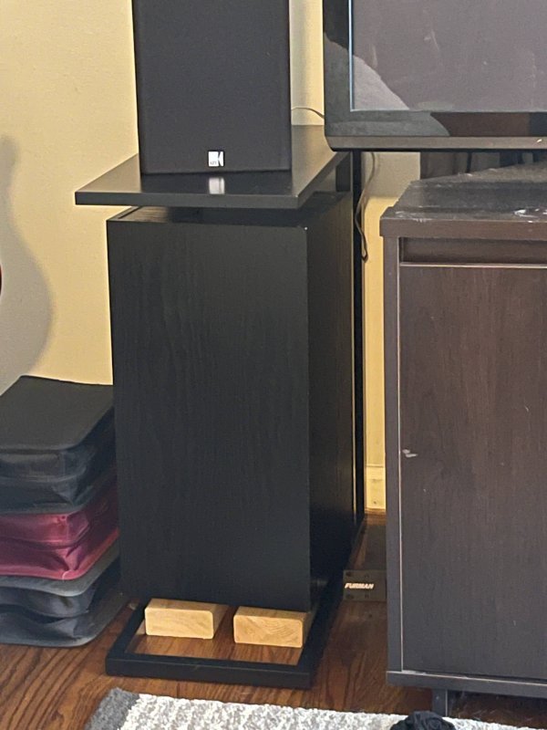

Ok, so -
i will post pictures at a later time but I could not wait to update yall on my results since setting these side tables up -
Bass response is DRASTICALLY improved; i cannot describe how much better it sounds, since the C15's arent in direct contact with the C200SW's anymore -- so much so, these side tables have saved me from changing my receiver. Obviously these speakers were made to come with the KB200 stands, but holy crap, these tables work SO WELL.
I cut up a 4x4 and bought some rubber isolation feet for the subs, to keep them separate from the metal frame. I was worried about isolating them, as it says in one of the documents that these are meant to go in the corners, directly on the floor, where the bass response is boosted into your walls, etc. But after hearing these setup with the side tables, isolated and all, there is almost nothing i want changed in the sound. SO MUCH BETTER THAN ON THE FLOOR AND IN THE CORNER. The bass resonates throughout the walls better this way too, imo.
Also ended up moving the speakers much close together -- 2.5m away from each other now (4.5m before), which is perfect because as long as you have the speakers separated from each other with the KB200 stands or these tables, you should not keep them more than 3m apart in a small/medium sized room.
Anyway, as I said before, the main reason for updating this thread is just in case anyone else needs info on the KB200 brackets that basically never existed according to KEF and the rest of the internet. So anyone looking for more info about these speakers, please dont hesitate to message me!
Hope everyone's having a safe, productive 2021 so far!

Thats awesome! i only went into this much detail because of how frustrated I became trying to find information on the original stands (I still cant get over its as if they never existed according to KEF or really anywhere online).
To isolate the sub from the metal base of the stand, I bought some rubber isolation feet (although i dont think the feet are 100% required, i figured theyd help just in case the wood underneath wasnt level) and then also set some left over scrap 4x4's - from a wood project my girlfriend took on - to set underneath the sub. The wood raises the sub up just enough so that the speaker doesnt come in contact with the metal frame.
Link for isolation feet here:
https://www.amazon.com/Platinum-Sil...dddb4&pd_rd_wg=3OOmS&pd_rd_i=B075KHNK62&psc=1
You can find the 4x4 at any hardware store or home depot, etc.
I didnt add any weight to the stand but your speakers are the larger version of mine, so you may want to. Although, if you keep the speakers not right on the edge of the stand you should be fine as i believe each stand is supposed to hold up to 50lbs or so.
Hope that helps! let me know if you have any other questions! glad you found my post helpful
