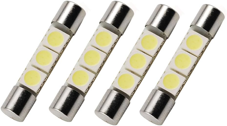

Well that was quick - powered up the receiver without the cases and I can see strong blue-purple LEDs shining bright! I guess they are either the wrong voltage or a previous owner just liked the colour...
I couldn't do this originally as the unit has the original 2-pin plug attached (I had to get hold of an adaptor to UK 3-pin as didn't want to cut it off), so I pulled an LED and bench-tested it in the meantime. It definitely wasn't the same colour at 12v on the bench. I then got distracted looking at other threads about tinted glass, thinking that's where the colour was coming from... It way well be that the glass needs re-tinting green anyway, of course.
Will replace with warm white LEDs ASAP.
Does anyone have a recommendation? Have read both DE3021 and 3022 work, so something like this https://www.amazon.co.uk/License-Interior-Reading-Replacement-Extremely/dp/B07VPGCDQN/ ?
Those LEDs probably won't fit. They protrude from the sides too far. You need ones that fit the profile of a standard fuse-style lamp, similar to these:
Measure the length between the clips on the lamp holders and find fuse-style LEDs of that length (or close.) As I mentioned earlier, the original lamps were festoon bulbs, not fuse, but the fuse-style will fit, possibly with a need to close up the clips a bit. No need to remove the face to get to the dial lamps. The the lamp holders come out from the back. You will need to remove the face to re-tint the ends of the dial glass, though, if necessary. (The original color is green.)
Voltage should make no difference in the color of the LEDs. The tint on your dial glass is most likely faded so someone probably decided the purple would be a good look, instead of the glare of a regular lamp with no glass tint. (In addition to coloring the light, the tint also diffuses it some.)
Thanks for the tip about not needing to remove the face, very handy to know. Just pulled the current ones and they are the same style you have posted (but obviously the wrong colour). Will replace with warm white and see what happens next...

I would like to see a pic of the LED's that fit in there. I couldn't find any! Dowojo couldn't either.
Edit: Actually, mine is a str-7055, so maybe they're different.
These are the ones I pulled out of mine - they work fine apart from the wrong colour. Approx 30mm length, 6mm width. Hope it helps.
Edit: They are a few mm longer than the holders but fit fine.
