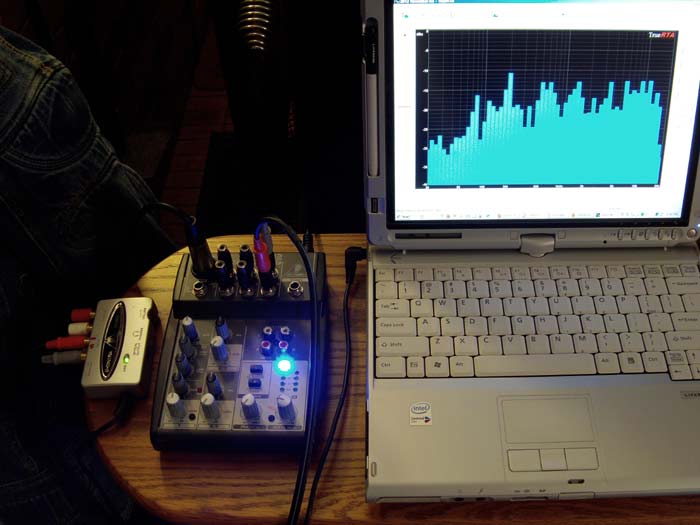

The UCA202 is handy if you ever get heavy into computer room eq too.
Come on ... you know you want to ... nudge nudge. :D
