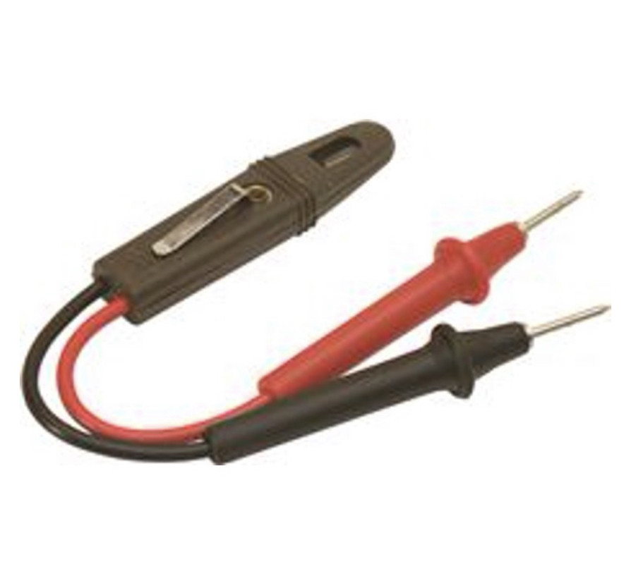

I also went looking for the below at the HW store. I could not find one-just the plug in and observe the status lights type. Guess the one with probes is too dangerous-lol
These pocket 120VAC neon test lights work too. Since they’re neon, they flicker at 60Hz.
