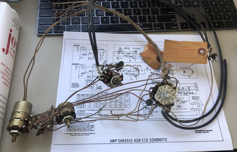

Hello gadget,
Thanks for the tips, that sounds very doable for me. I have a photofact for the amp:
I am very new to reading schematics, but from my understanding, it does not look like there are any more tubes in the tone control circuit which is after the 3 prong connector downstream of the 7199's. I believe that the entire tone control circuit is actually wired straight onto the pots.
Does this design mean loss of gain? I'm assuming that the capacitors and resistors are required to isolate the parts of the signal which will be controlled by the bass and treble pots.
Also, the speaker leads go directly from the top of the output transformer. Is there something I can do to make this less messy and route it through the underside of the chassis to some banana plugs I will install? If worse comes to worse I can thread them through the hole all the other wires coming out of the transformer bottom go through, and maybe get some transformer bell covers I guess.
Thanks!
ah, so its fully passive then. That might work with other sources but I'd give it a listen first before drilling any holes. I'm generally not a huge fan of tone controls just because so many of them sound bad. Best I can suggest is to judge for yourself.
The caps are where it sets the turnover points. It ends up forming high and low pass filter networks so when you adjust the treble it affects frequencies above some point, or below some point with the bass control.
and yeah its very lossy. This can't boost anything, so the way it works is when the controls are centered you get an approximately flat cut of so many db. Spitball, probably something like 6db, which is a 50% loss. The "boost" function simply cuts less. The pentode part of the 7199 is a high gain section so they may be making up for the loss there. Doesn't look like there is a whole lot of global feedback in this amp, so it probably doesn't need very much signal to get full output power.
should be able to loop the wires down underneath to clean it up.

Did some reading on this subject, and it seems like quite an argument.
If I understand that statement correctly, I would rather not have the over loss in signal, as this is a rather low powered amp already, and perhaps this will make my need for high efficiency speakers less severe?
Also, as I understand this schematic, there is no prea-amp inside the amp chassis correct? Does this mean that I would need a separate preamp to run a turntable?
it won't reduce output power, it just increases the amount of signal from the source needed to get to full output power. If this has any sort of sane design even with the loss in the controls it probably doesn't need crazy levels of signal to get to full output power. Those phono cartridges typically had output in the 1/2v range, so you shouldn't need more than that to get all 3 watts of power it can deliver. Without the tone controls it might be closer to 0.1 volts to hit full power.
again thats mostly just educated guesses but I doubt its completely off the mark. One accurate measurement is worth a thousand expert opinions though.

Ok, after reading your comments and doing some more research, I think the best and easiest thing to do will be to follow your advice and wire in one selector switch and one volume pot. If I feel like I need tone controls I can always add in an equalizer at some point in my system. Ditto for a phono preamp.
