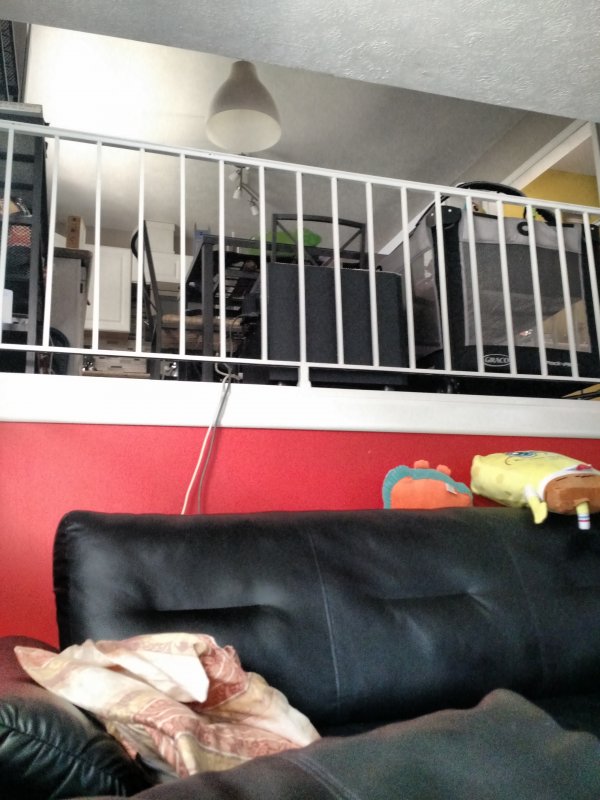

So i ended up getting a Velodyne VA-1512 that has an upgraded driver from a Velodyne F-1200 for $125. :thumbsup:
Sounds pretty great!
I actually have the subwoofer placed on the split level above my listening area. It sounds pretty good but has some minor localization issues (40Hz x-over).
Would multiple subs help remove this localization?
If you're having localization issues with a crossover frequency of 40Hz the sub is most likely way to loud. OTOH there are definitely other issues such as, it being on another level.

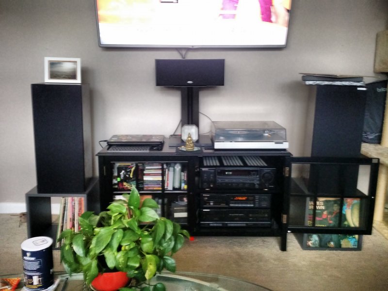

So ironically, I ended up getting an M&K VX-7 MK II (mentioned at the beginning of this thread) and a Polk center channel both for $20. My system is now officially 3.2.
I placed the M&K on the floor with my mains. This really seemed to even out the bass response and helped with the localization issues. I also had noticed the Velodyne was creating a standing wave at the main listening position. I moved it forward about 3 feet, with the help of this 3D room mode calculator/visualizer.
Room Mode Calculator
(w/ my room for reference)
Messing with the room/placement has really got me interested in doing some more room acoustics tweaking. The M&K is behind James Brown. Sounding good!
Quick Update:
I, once again, have reorganized my layout.
The dual sub setup helps even the response across the room for sure. (Energy users, don't be afraid to have two subs).
Placed the subs mid-wall across the room.
See the attached image.
However, the Energys seem to be acting like subwoofer as well.
I have been trying to tame a 50-60Hz peak in the room.
The mid wall subs helped reduce boom, but i am still getting some frequency peaks due to the listening position near the wall.
