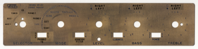

And now I have the truly crazy thought to make a new brass faceplate for this thing, relettered to better reflect the current functionality. Though if I'm going to do that, it would make more sense to use the MIC input as the last line level (labeled as "TAPE" and use the spot now labeled "TAPE" as "PHONO 2," so all of the line level inputs are together.

Here is what I did with mine, as well as my HF-81. I kept the tube rectifier, but doubled or tripled capactances, then split the phono stage B+ into two rails, one for each channel.
The tube rectifier is more than adequate and lends the sweet sound. The AC filaments also sound sweeter than DC fils, imho.
I made the Mic and Tape Head inputs into phono inputs. The Tape Head switch gave me two different phono playback EQ curves. The useless Loudness switch became a Scratch Filter. This displaced my reference KT-600 and Paragon E ten years ago.
