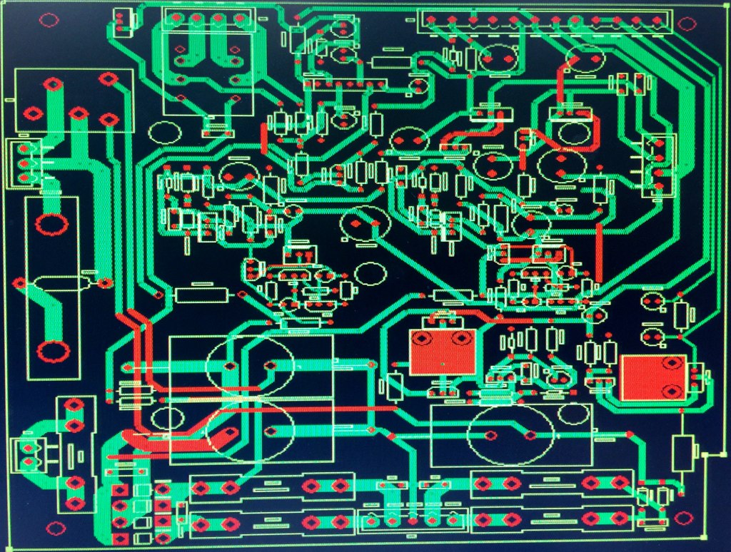

Last look before build..
OK...
Here is the board and schematic ready to be built.
We will send the design out to have the boards built tomorrow unless there is an error. We will get a minimum qty to make a test with. If it's good we will make more or modify till it's perfected.
Thanks to Mitch G for the layout! Also thanks to Glenn, Mark, Lee, RCS16, zebulon1, Solderiron, building nut, and others that helped with suggestions, comments and encouragement! :D:D:D
All of the parts except the power resistor and protection IC are available from Mouser. The IC is available from a few sources and the resistor is a digikey part.
Improvements from the original:
1. All wires are now on connectors for easy install and removal.
2. 80V reg transistors have been moved to the large heat sink.
3. The large electrolytic caps have mounting provisions for axial or radial.
4. The current source mod has been integrated into the board.
5. All of the substitute devices have been orientated with pad layouts that match the pinout of the device.
6. The board has been silkscreened with components id.
7. The board has an internal ground plane. This is a bit subtle when you look at the layout.
8. Q203 and Q205 have larger heat sinks
9. The board can be built from 100% new components.
Why use the MY2 relay layout? The original speaker relay, though having the same pinout as the modern Omron MY2, was capable of over twice the current. If you have the freedom of new design, at least set it up where the speaker relay is an LY2-0-DC48.
Same sort of deal with the soft-start relay...the LY1 is a major PITA to locate. Replace with an LY2. Either the LY2-0-DC48 or the LY2-DC48.
Good catch.. :yes:
We planned on using the MY2-02-DC48 and LY1-0-DC24.
We need to look at the changes made to use the 24V relay and revert back. Probably just make them the same LY2-0-DC48.
If we're going to use different relays, the 48v specification is a limiting and sourcing pita.
We can tap raw DC 24v and use 24v relays for both. LY2-0-DC24 NO R102, R308 3.3k 2watt metal oxide dropping resistors needed.
Call it 38mA each, instead of 19mA each from the 99-106v line and throwing half the wattage (voltage) away as heat.
I have been doing so in my repairs for a while. No problems.
I HAD to use ly1-0-dc24 relays because the 48v relays became difficult to find.
To be clear, Mark is talking about tapping the 24V at the positive terminal of C203 (or any equal-potential point from there to R202 or R203).
So, that would make both the soft-start and speaker protection relays LY2-0-DC24. And dumping R102 and R308.
