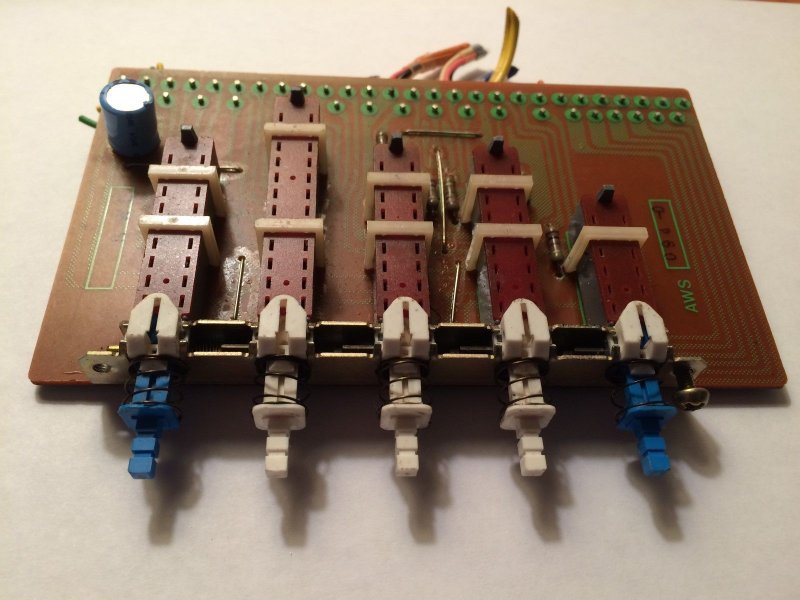

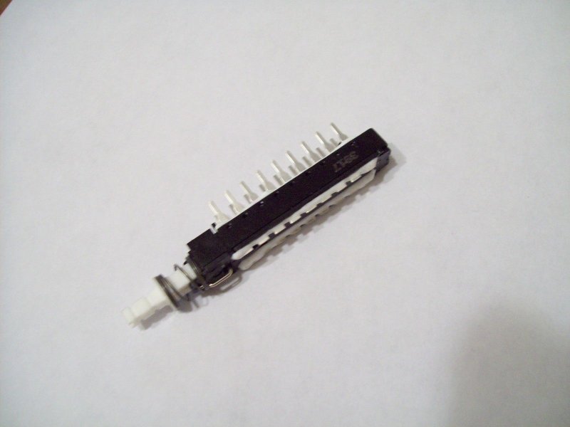

I'm seeking words of wisdom in regards to switching out the old switches on the AWS-094 and AWS-095 boards. They no longer stay engaged. Has anyone tried to use a modern 6PDT and similar as a replacement? Which brand works best with the least amount of modification?
This is the board in question
This is a possible replacement candidate.
Thanks everyone.
You are apparently unaware of the mechanical interlock which holds the selected switch in, and pops the others out.
Faderlube the front metal channel where the transfer bar resides, in the front of the switch.
WATCH OUT for the spring!!

I am aware of that. But I'm also aware that when they get worn out they do not stay fully in the "in" position thus causing dropouts. It a known issue with these switches.

Now don't mistake my skepticism for disinterest, I looked at the thread title and momentarily HOPED you had found something compatible WITH the interlock mechanism and was modern - because modern means that gold contacts could be obtained. I would LOVE to be able to just BUY switches and install them on a refurb job, instead of removing the originals, disassembling them, cleaning and then ultrasonically chemically cleaning them, and then reassembling and reinstalling them. If I could get gold contacts (even if I had to shell out some heavy bucks for a minimum "not stocked" order quantity) that would be fantastic because almost ALL of the switching in these models is of a low enough current density to allow the gold contacts.

HairySatchel, are you 100% sure it is the switch and not the alignment with the front panel aluminium buttons and the captive springs? The switch PCB must be carefully installed to centre the switches with a test fit of the front panel. This should be done for each switch bank.
That, along with the lack of lube in the self-cancelling slide mech that MTF spoke of will give you headaches.
The springs on the aluminium buttons are IMO installed by Pioneer the wrong way around. They are tapered and the wide end should be installed against the panel with the narrow end facing the switch shaft. That way, the wide end, never gets caught under those nasty little retaining clips that 'stick' the button in a depressed position.
I too, have never seen a self-cancelling switch bank mechanical failure apart from a snapped off shaft.

This assumes that you have deoxited the switches in question. If not, deoxiting is the FIRST step in just about anything.
Deoxiting plows a clean path through the Deoxit loosened corrosion, which then the sliding contact that floats in the center shaft recess can jump out of with mechanical shock.
Which means that taking the deoxited unit off the bench, OR shipping, can undo the deoxiting.
So I remove the board, desolder the switch from the board, and disassemble the switch - then use an eraser to polish the blades in the body of the switch clean.
Over the years I have gotten pretty good at disassembling them, cleaning them and successfully reassembling them.
One MUST distinguish between the model years, the xx50 series switches can be mechanically polished,
while the xx80 contacts are shrouded and pretty unreachable so I remove, partially disassemble and ultrasonically clean them with a custom cleaning solution.

Thank you @markthefixer for the input. I recalled as I looked at the schematic that though I had made a very crude attempt at Deoxit-ing these buttons, I never got in there due to the board being blocked from the bottom. I was uncomfortable removing the board to access the buttons. Well a few years later and I'm gained some experience on less desirable pieces.
Long story short, Deoxit appears to have done the trick at least for now. We'll have to see if it reemerges, but for now it's solid as a rock.
It really wasn't that tough getting the board out but it did require unbolting two boards and removing the wiring from the holders. Didn't require desoldering anything or cutting any wires.
