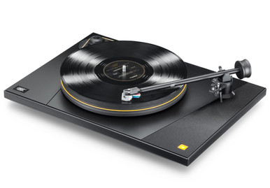

I would highly recommend a Mofi Ultradeck. I liked it much better than the Rega P3, or the Pro-ject carbon, that I had prior. It's made in MI. It's been discontinued, and it's been marked down for $1,000 less than when I got mine. Check other retailers, some still have an option to bundle a Mastertracher cartridge.

I would highly recommend a Mofi Ultradeck. I like it much better than the Rega P6, or the Pro-ject carbon, that I had prior. It's made in the MI. It's been discontinued, and it's been marked down for $1,000 less than when I got mine.
